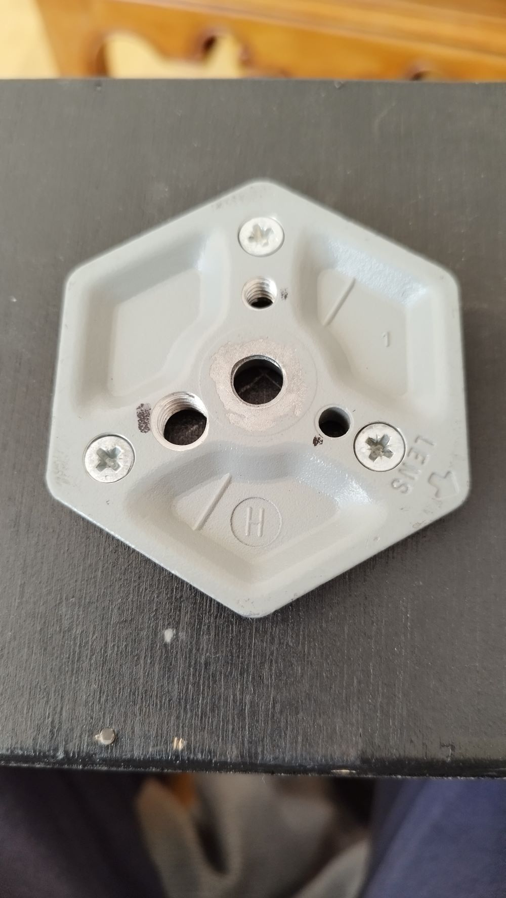

I've built a very basic box camera. Wooden box, magnifying glass as a lens and a 4x5 filmholder.
I would like to be able to mount it in a tripod, but I don't know how to do it.
I have a pinhole camera that has this thing screwed in the bottom.
As you can see it has screws for different screw sizes of tripod. I think it could be a good solution, but I don't know how to search for it online How do you call it?
Any clue on how to search for it or where? Any other idea?

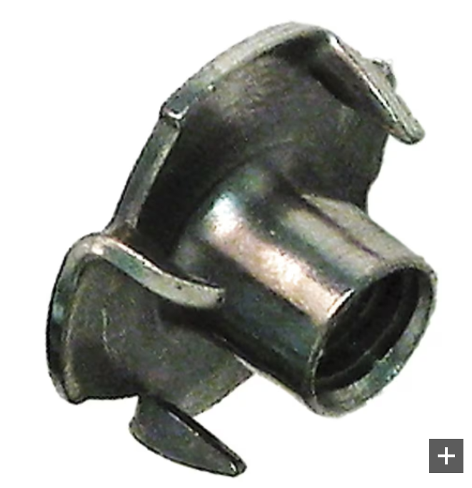

Go to the hardware store and get a "hammer-in" nut the same size as your tripod screw. I don't know what these are called, but you drill a hole in the wood and then this bolt is hammered into the hole. There are three or four tabs that keep the nut in place.
Someone with jump in with the correct name for these nuts -- right now it's driving ME nuts. They are used in furniture building all the time.
You'll need to seal the inside on the camera once you drill the hole for the nut.

It looks like someone customized a hexagonal quick release plate from a tripod.
The holes for the three screws would not normally be there ... I think they drilled new holes for that.
Kino
Jan 20, 2006
7,763
Orange, Virginia
Yes, that's a Manfroto 130-14 Quick Release Tripod Plate that's been modified. Not a bad idea if you have a matching Manfroto tripod and a few of these plates laying about unused, otherwise its an expensive adapter if bought just for that purpose.
As suggested above, get the T nut, but I would suggest you mount it on a separate block of wood a little thicker than the T nut and then glue or screw it to the bottom of the pinhole to maintain integrity of the light chamber. You can also do this with a common 1/4/20 hex nut driven into an undersized hole and epoxied into the wood strip if you can't find a T nut.

The hammer-in T-Nut is a good solution.
Note the T-Nut needs to be hammered in from the inside of the camera. Tightening the tripod screw should pull the T-Nut into an even firmer grip on the wood. If attached to the outside the T-Nut will be loosened as the tripod screw is tightened.
The wood needs to be the right thickness - too thin and the threaded section may stick out or even the 'tines' of the nut may break through to the other side; too thick and the tripod's screw may not be able to reach the nut.
If the camera's wood is thin then gluing a block of wood inside the camera will provide enough thickness.
You may, however, find that 1/4-20 T-Nuts are hard to find in the EU (but what do I know, I've never tried). Even a 1/4-20 nut carefully epoxied to the inside of the camera would worn - assuming the tripods screw can reach through the wood.

As others mentioned, the hexagonal plate you have there is a Manfrotto hexagonal quick release plate, with the central screw removed. Like this one: https://www.bhphotovideo.com/c/prod...to_130_14_130_14_Hexagonal_Quick_Release.html
These plates also have 1/4 and 3/8" threaded holes, so you can mount them on a different tripod, if the tripod screw is not too long (it may bottom out on the bottom of the camera). Naturally, the hex plate works great if you already use a Manfrotto/Bogen head that accepts it, but is a bit of overkill if you don't.

I would vote for the T-nuts, at least here in the US, they are available with 2 or 3 different lengths of the tapped cylindrical portion which can help match the wood thickness. I have used them on a 4x5 and an 8x10 pinhole camera. I have made the holes almost a press fit and bedded the nuts in glue or epoxy so they can't wiggle.

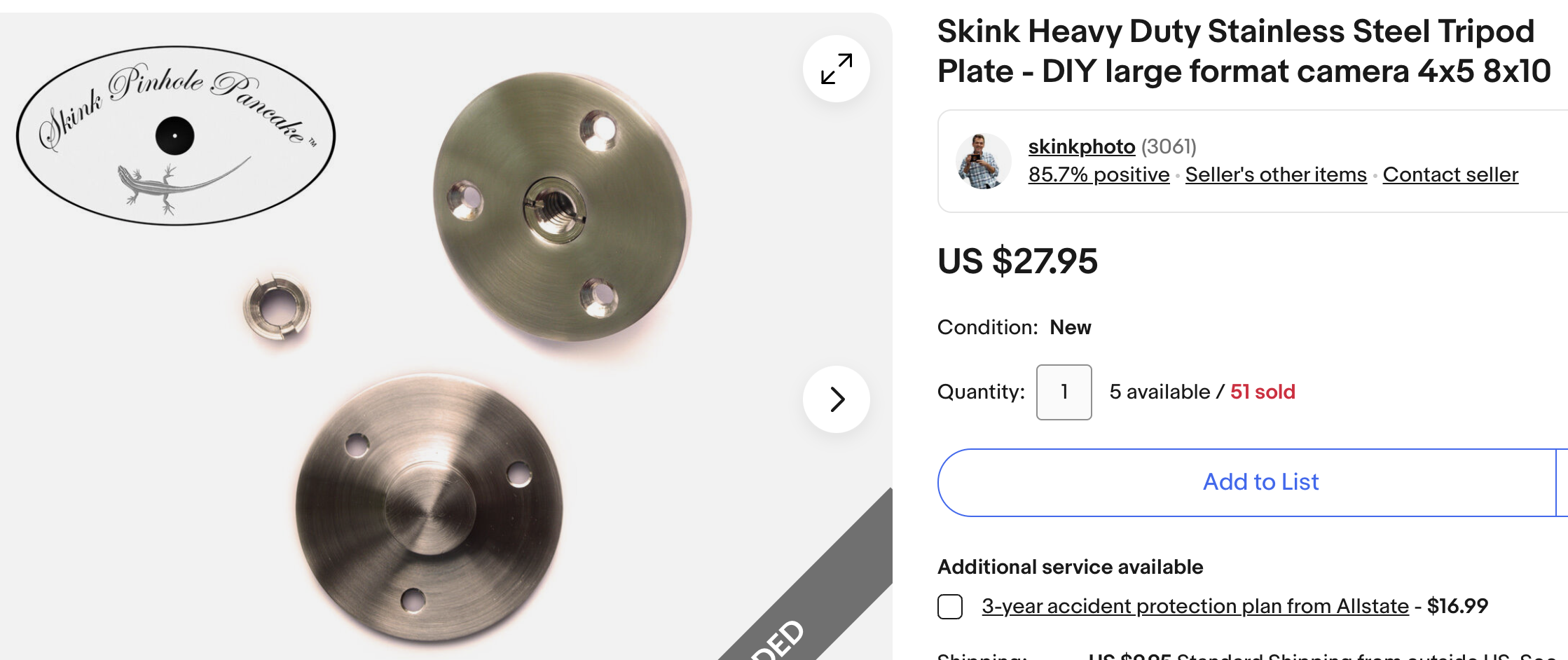

NO AFFILIATION. But, I'd use this. View attachment 360708
Looks like a nicely made piece of work. Your screen shot looks like it might be from eBay, but I can't find a seller by that name on the USA eBay website. With an approval rating of only 85.7%, I probably would avoid that seller, anyway.
@Jaume Tormo, I see you are in Spain. There is a machinist in Portugal who makes some nice lens adapters. He does not offer what you are looking for as a stock item, but I am sure he is capable of making something like shown above in either brass or aluminum. He does some custom work, so maybe he would be interested(?) His name is Jose Meneses and his website is https://customphototools.com/

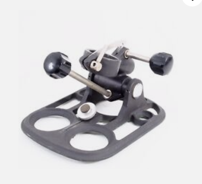

The easy solution would be to get a used pan/tilt head made for a large format camera. (See attached image from a current eBay auction.) It will have a big flat base. Use a bungee cord to attach the camera to the base and you're ready to go.

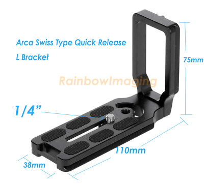

Or, if you already have a tripod head that accepts Arca-Swiss plates, get an L-bracket and bungee-cord the camera to it. Here's one on eBay for US$10:
I use one to mount my iPhone (with a hair bow) on a tripod. Useful and inexpensive.
