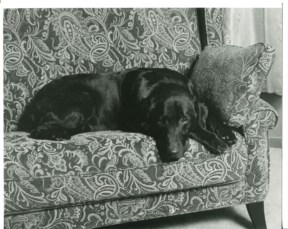

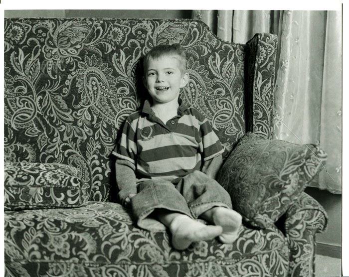

Had something of a breakthrough last night. I decided to try some variable grade printing for the first time to see if there was anything usable to be found in some of my under-developed negatives from the other night (see the stale Ilfosol 3 thread), and surprisingly, I got some halfway reasonable results.
These were both printed with about 10 seconds of exposure with the "00" filter and about 15 seconds with the "5" filter. I've got some better negatives to work with, and I'm going to see what I can do with those next.

That's my understanding, but it worked here. They look pretty good. The boy is a dead ringer for one of my Grandsons - could be his double.

Does printing with a "5" and a "00" give you the same result (assuming the same exposure times for each) as printing with a "2.5"?

If it were me, I think I'd be questioning how much under-development there was. The range of tones seem excellent. Maybe serious under-developed negs can be made into as good prints as these with split grade prints and if so I wouldn't be too concerned. The range of zones in the prints, especially in the dog picture looks excellent.
The "rule" seems to be that higher grades can rescue a neg but never fully establish the range of tones that a neg capable of grade 2 printing can but I'd have to say that the dog split grade 5 print looks very good.
Just as a matter of enlightenment - well for me certainly - could you try a straight grade 5 print and see if it is as good as the split grade print. The wisdom here on under-developed negs seems to be that split grade achieves nothing that a higher graded straight print s can't.
I'd be interested to see if that is the case
Thanks

Back in the darkroom last night. I tried printing the photo of the boy with a "5" filter only. Even with a crazy-long exposure, it was nothing but black and blank. Pure black shadows and nothing anywhere else. Interesting.

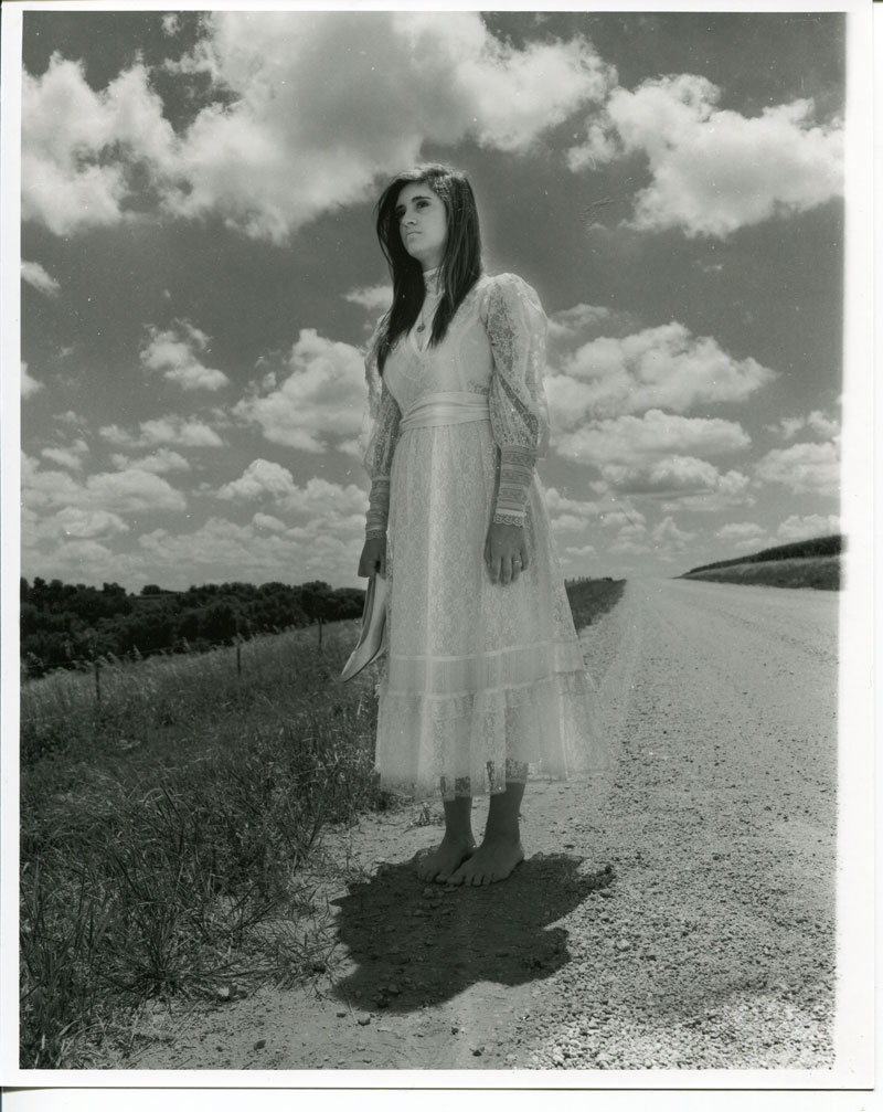

I decided to take a chance and pulled up a different negative that I shot last year. I was more confident in the exposure and development on this one, and have to say, I think I'm figuring some things out here. My first prints were so "dead", and I was (mistakenly, I think) concluding that I had problems prior to printing. This result suggests to me that my negatives (or at least some of them) are just fine, and its the printing that makes the difference...an observation that agrees well with some of the comments made here.
Anyway, with this one, I wanted to darken the sky as much as I could, so I printed for 40 seconds (seemed like an agonizingly long time) with the "00" filter, while dodging out the subject. Then came back and hit it for 14 seconds with the "2.5" filter with no dodging.
I can see that I need to work on refining my dodging technique, but other than some glitches there, I'm starting to like what I'm getting here.

40 seconds 00 does not sound like too much to me. It depends on the light in your enlarger, I suppose. Mine makes very little green light, so my 00 exposures are long compared to 05. I typically aim for about a 20 second main 00 exposure, and it would not be uncommon to go another 20 for a sky, especially to get it as dark as this one. My main 05 exposures are usually only a few seconds and very rarely more than 10. Depends on film and filters used too... a yellow filter with FP4+ can get the sky close to what I want with only a little burning.

Dodging around figures, such as the girl projecting into mono tonal areas such as sky, or conversely burning around her, is difficult work. While I applaud your effort and willingness to improve, such things can be impossible to do with any amount of excellence without masking. Another approach to fine tuning the photograph is to use a filter to improve contrast in the sky without harshing the girl's face, but alas the art of compromise (in exposure) is likely to be your friend in these situations. Here is where pre-visualization meets the art of the photograph.

I wish on that shot I had used a reflector to throw some more exposure on her face. That't the hardest part about that image.
