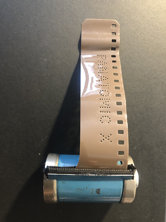

While doing some cleaning at my work (at a university), I came across an unopened box of 35mm panatomic X that expired in 1948. Its the reusable cassette that has a hollow silver center with silver caps, and didn’t even come in a can— just a foil wrapper. Wildly enough it has a huge leader (4”) with “PANATOMIC X” punched into it. It was definitely not stored in good conditions, think an old attic, so I’m not sure if it’s going to give anything usable, but what the heck. For exposing I was thinking to do a stop or two over, so ISO 8-18, and developing in 60° HC-110 for 7 minutes. Will this work well or should I give it less compensation?

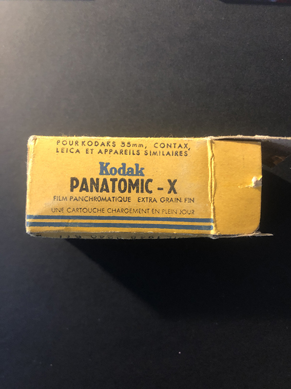

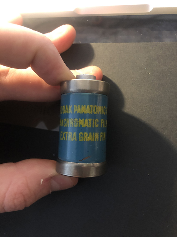

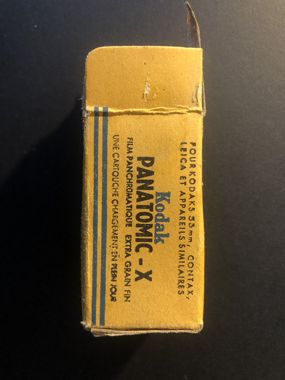

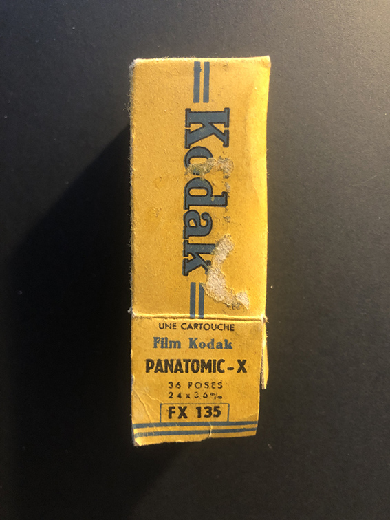

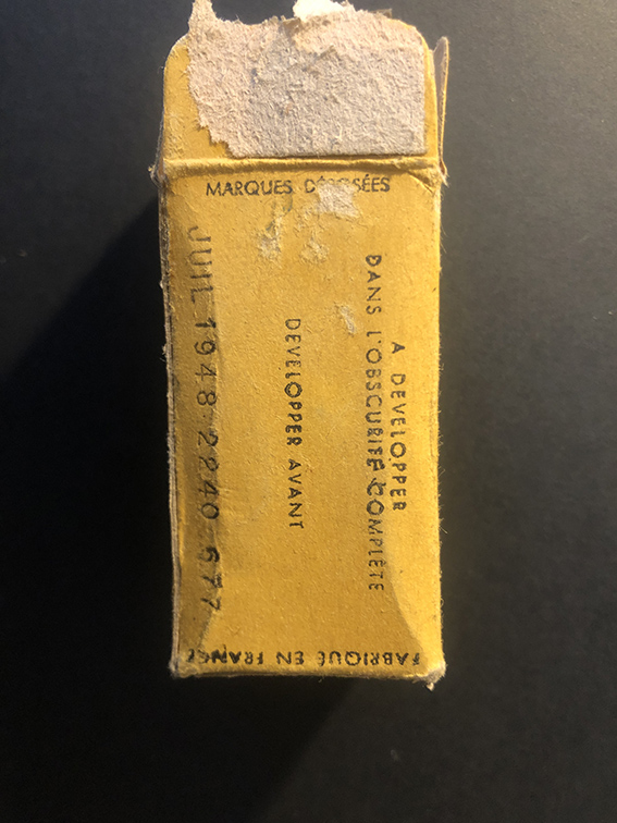

Was Pan-X rated 32 (now 64) ASA in 1948? There is no ASA indication on the box of mine, and wildly enough it says on the box it was produced in France. Don't know how I missed that the first time round, the whole box is in French. Here's some images of the carton and cassette. Even the sparse casette writing is in french. Also, it appears to have seen some use already, was Kodak reusing cassettes in the early days? In any case, Ive got the film in set to ASA 32 now.

The long leader was to fit into screw-mount "Barnack" Leicas and other bottom-loading cameras. Nice artifact you have, better as a museum piece than as usable film. It's not like you'll find another!
