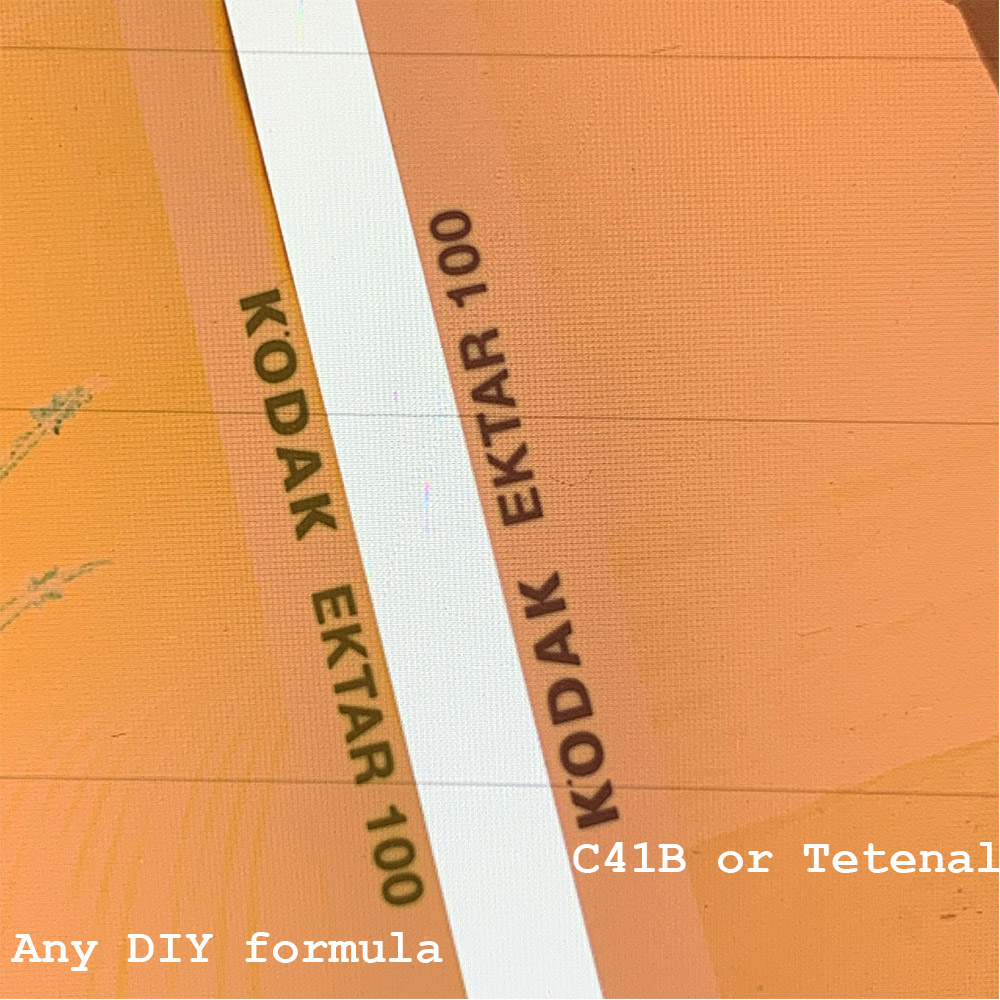

There is a problem with all DIY C41 formulations.
Unable to maintain PH 10.05,and having normal,verage colors.In order to keep the shadow details,have to raise pH,then Overdevelopment of Cyan dyes,One hundred Formulas,No exceptions.
This problem is evident in Ektar100 films,Ektar100 is the only way to detect developer.The skin color of Ektar100 will turn red if the pH is too high!!
It must contain a substance used to inhibit Cyan dyes(or accelerated magenta dyes,I can't be sure).
I found hydroquinone(123-31-9) to be barely achievable, but not perfect, or just passable ...no more than 10 mg per liter
