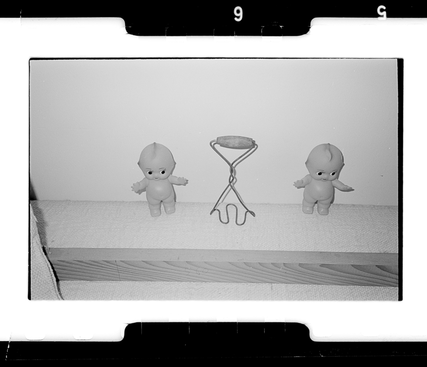

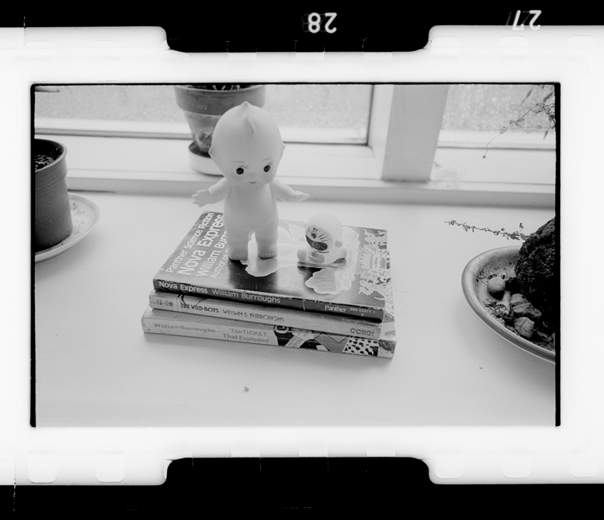

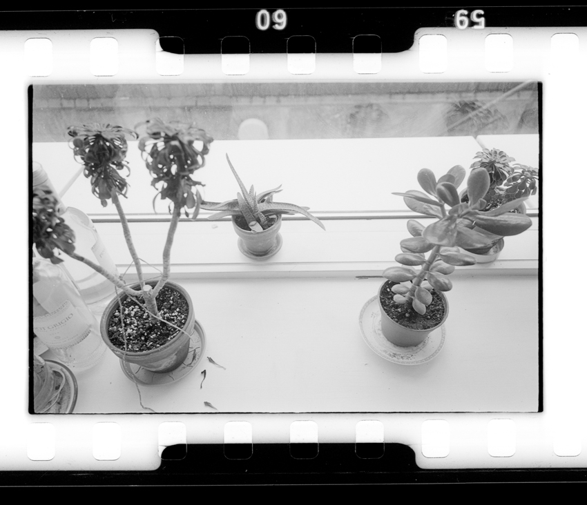

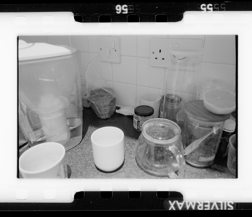

Hope this is the right place to share these Silvermax 100 ASA photos.
Developed 10m at 21.5 C in SIlvermax developer 1+25. (compensated time for high temp of developer)
Scanned on flat bed only with levelling applied.
Shot on Ricoh GR1s.

Thanks. I used a standard and quite old Epson 4490 (I think that's the model number). It took me a bit of experimenting to get the best results. Happy to expand on my technique.

I think the tonal gradation is a quality of the film+dev. I was careful not too disturb it too much when I set the lowest and highest values. I wanted minimum contrast without losing a few blacks. The scanning is simple - I dismissed the plastic neg holder and lay the neg flat on the glass emulsion side down. Somehow I feel lucky that they came out so well - but it was as if the film/dev/scanner combination already knew exactly what I had envisioned.
I would like to try the film in R09, next. It's not necessary, but I'm a little curious.
This is a nice film.

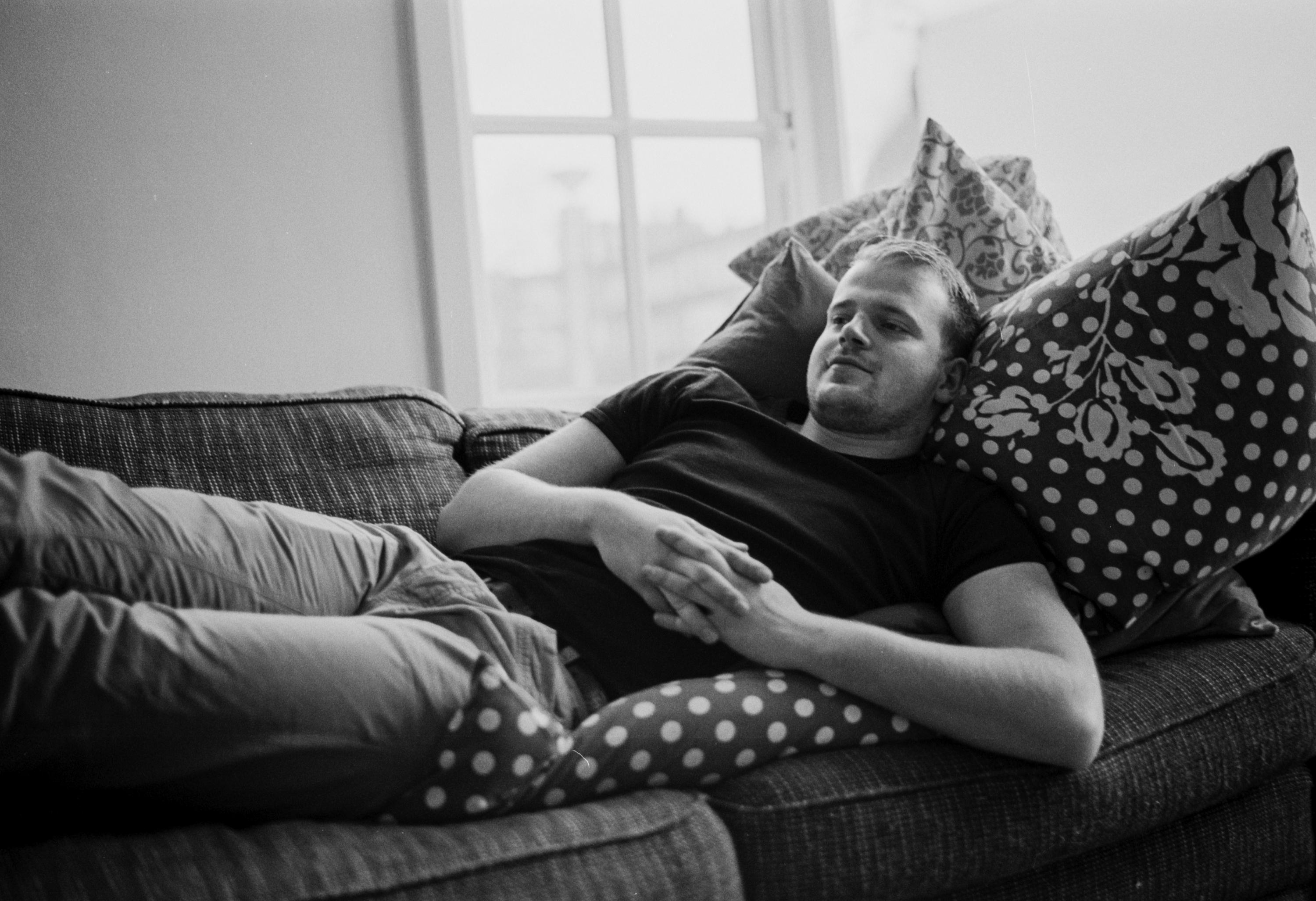

I've been using the dedicated silvermax developer so far. Probably going to try either HC110 or t-max developer next as I ran out of the dedicated stuff.
I haven't got most of my scanned shots on this laptop, only this shot of a friend.
Tech info:
Leica M6 with a zeiss 35mm 2.0
Silvermax 100 @ EI100
Silvermax developer used at 20 C for the prescribed time.
Scanned on a plustek optifilm 120
Contrast boosted in Lightroom. No other edits.

A good range of tones. Look forward to seeing some HC110. I have a feeling that using Silvermax too often is going to expensive - especially when I process a Super 8 reel of this film stock..
