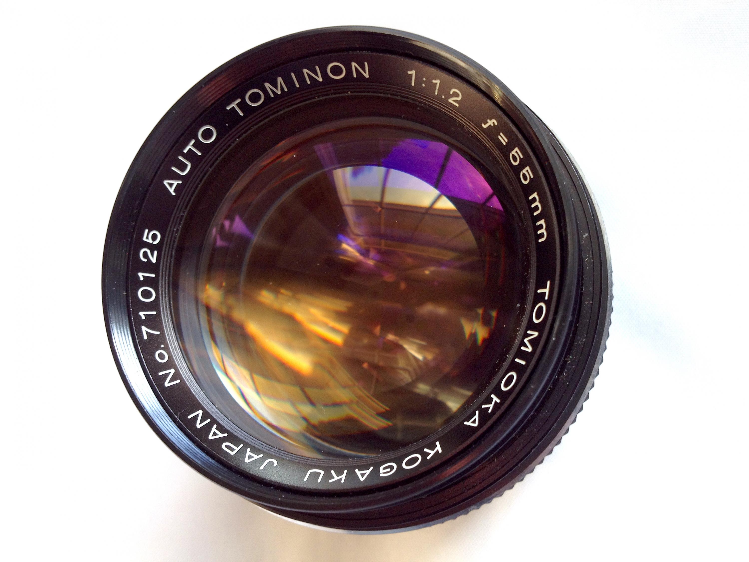

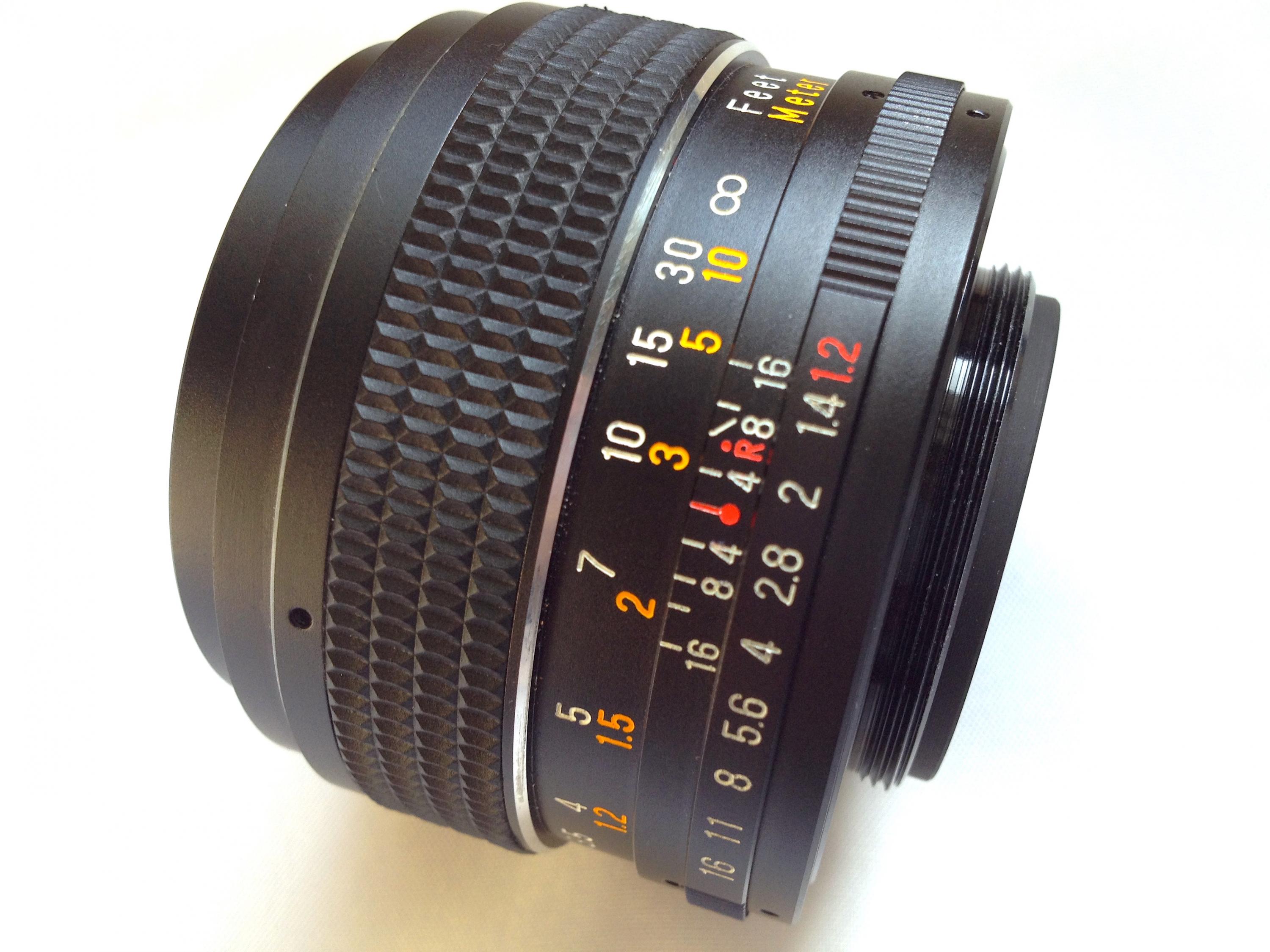

I just found one of these Tomioka Auto Tominon 55mm f/1.2 lenses yesterday for next to nothing. It's the Kogaku version with the m42 mount. Apparently its a valuable collectors lens because it was the fastest m42 ever made and there's only around 300 of them, but I just want to use it with my Canon 5D Mk III.

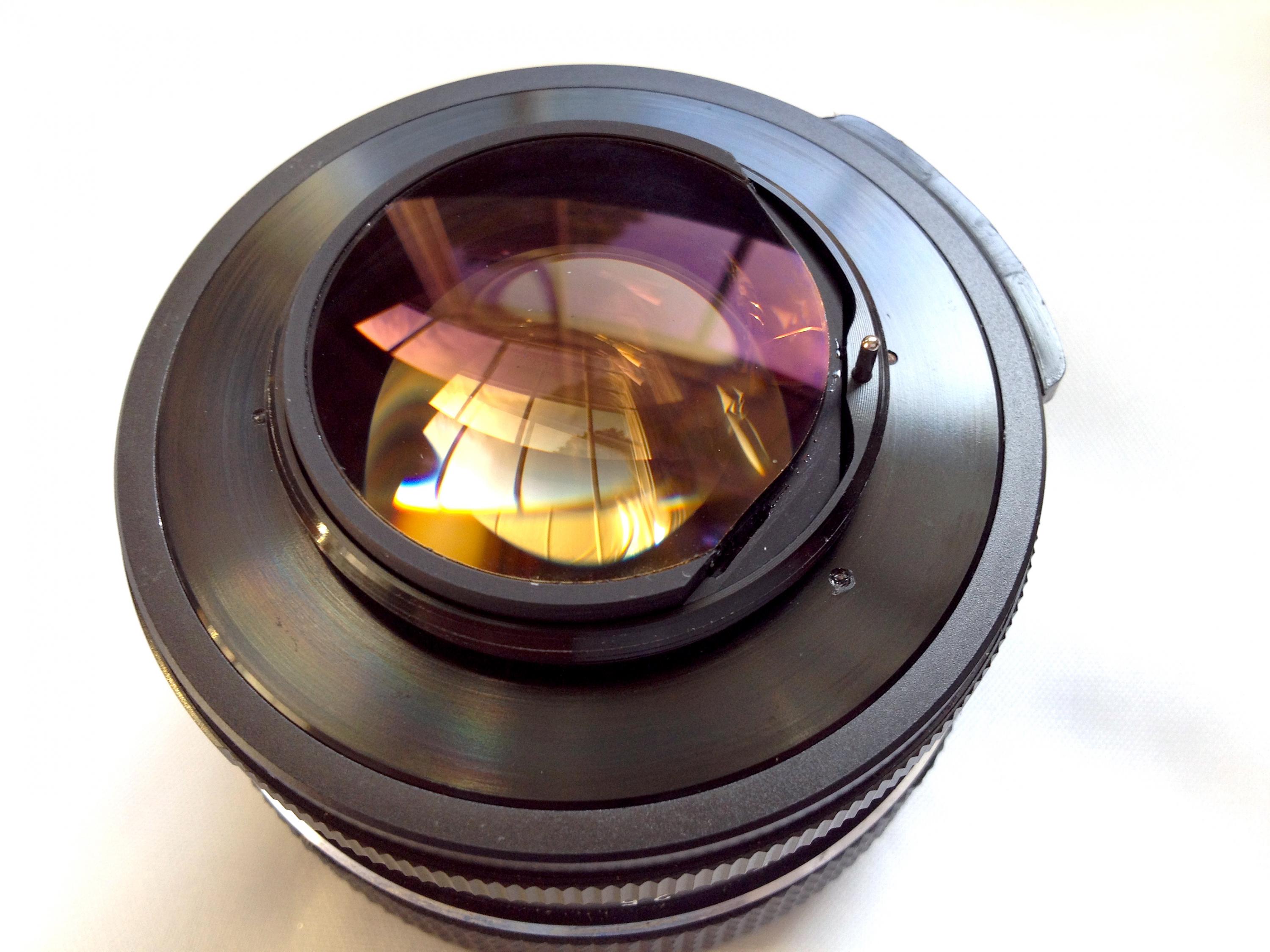

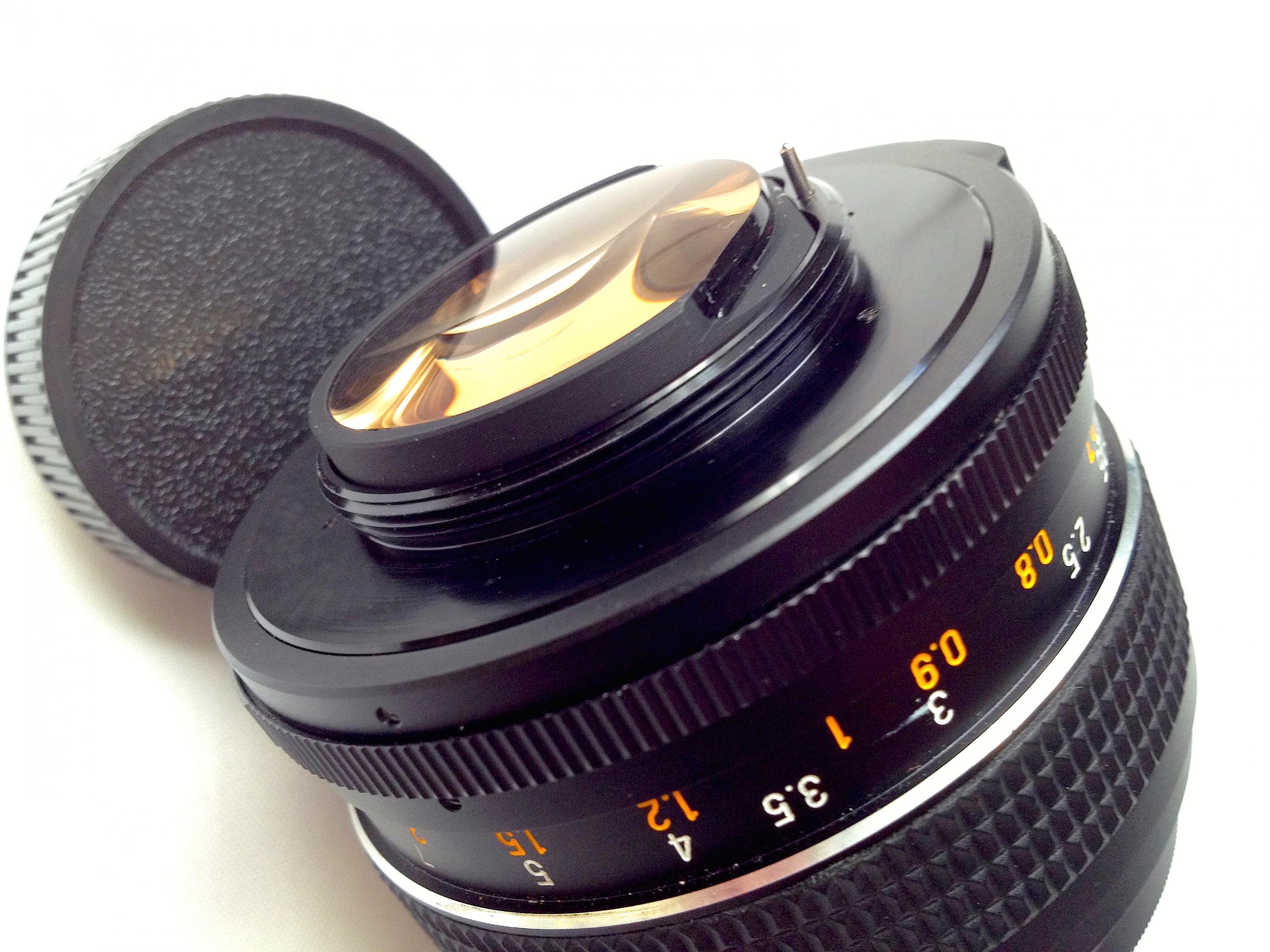

The rear element on the Tomioka is so large, it bumps up against the rim of the M42 to EOS adapter, so I can't focus past 7ft/3m. My Pentax and Mamiya f/1.4's don't have this problem. So I guess the solution is to purchase a non-flange EOS adapter for it? Or is there another way to get this on my DSLR without damaging anything?
Has anyone here used one of these Tomioka's 55mm f/1.2's? Just curious about the image quality and if they live up to the hype. I found this 'fan' website and a few Flickr sets, but not much else:

Would using the m42 to k-mount, then k-mount to eos work?
I thought about that but I don't have a k-mount to EOS adapter. I just bought a flange-less EOS adapter off Ebay....if that doesn't work, I guess I'll get a k-mount adapter and give that a try.
