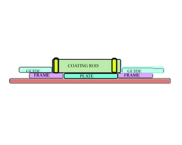

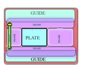

On the subject of equipment, I have constructed some glass and Super Glue frames for coating of glass plates in total darkness. I can position the plates by "feel", then just move the coating rod in one direction. See Attachments.
Bill:cool:

The reason I posted this is that I am coating in TOTAL darkness. I usually pour-coat ortho emulsions. But I cannot imagine pour-coating without some light. But I suppose that was what was done with the first commercial panchro emulsions. Of course, what helps one person may hinder another. I have found that the frames that I have made minimize bungling around in the dark. Also, taking ten slow,deep breaths between movements helps.
Bill
To All,
I first started working with glass frames as a result of Denise Ross's description on her website " Thelightfarm.com". The only thing that I he added are the "Guides" on both sides of the puddle pusher.
Bill
The purpose of what I have labeled as "guides" in my diagrams is to hold the Puddle Pusher to one path. All sheets of glass are glued down and do not slide.
Bill
