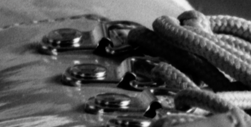

Sure, but let's be honest - even on rather flappy 8x10" film it's possible to get decently sharp results. This is a snippet from an 8x10" Fomapan 200 negative scanned at 2400dpi with some sharpening applied in post:
It's a little grainy because it's developed for carbon transfer, so massive contrast
