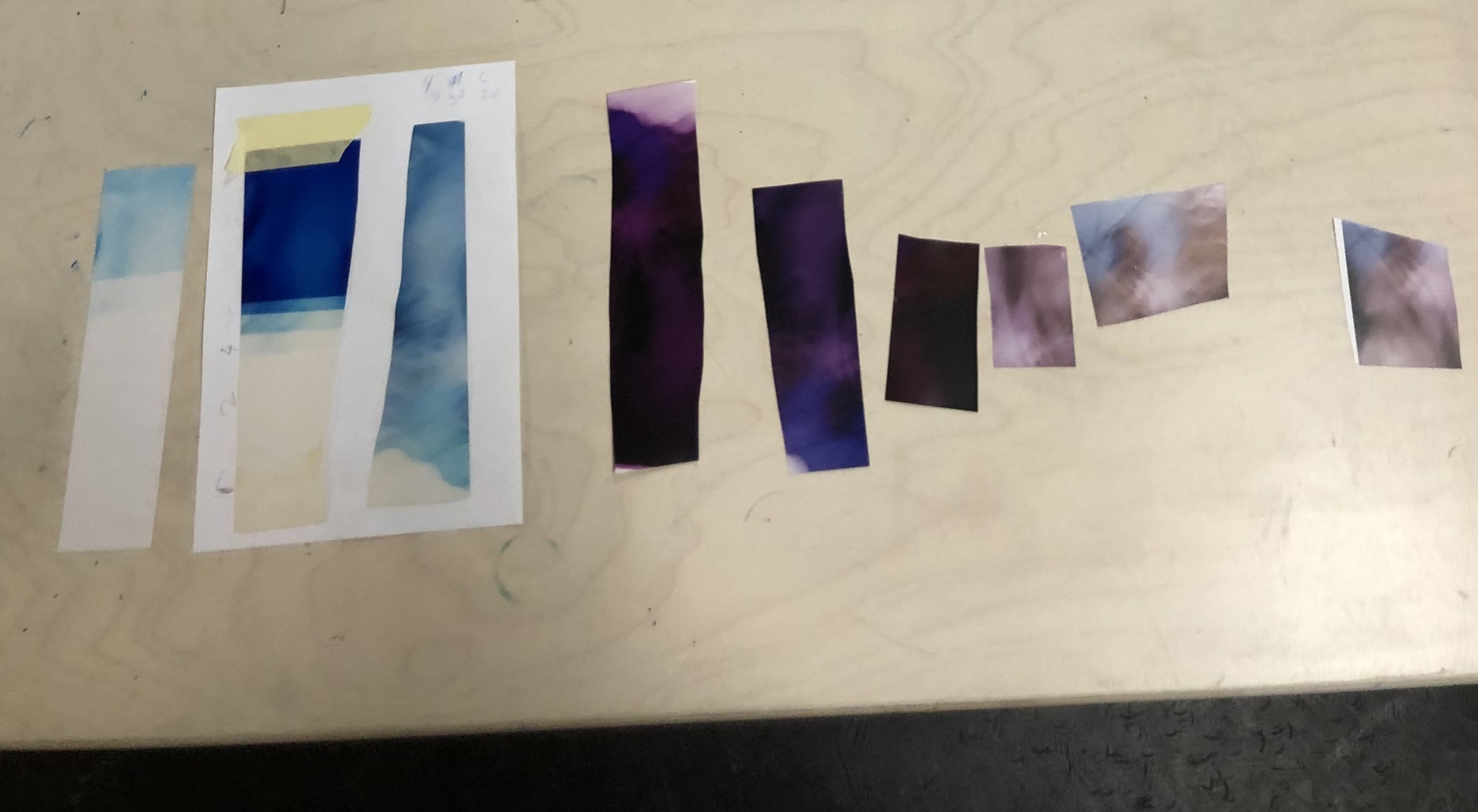

Now on to yesterday's session .........after 6 months I got the Durst out of her hiding place. I notice some "crystals" on the blix rollers so I did a "for me" proper cleaning. I put on a radiostation and made some fresh RA-4 tetenal chemie.
Mistake nr 2, I made 3L developer instead of the 2.5L (1;4 ratio). I was listening to the radio too closely.
I set the temp of the Machine to 38/39 degrees so the developer would react better (dilution is not as advised)
Started with my last color setting 100Y 85M ........and got Blue ......with some extra tests got "lucky" after 8 tests

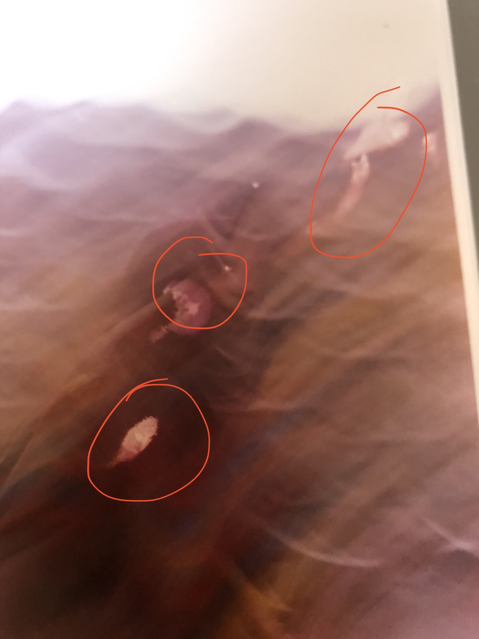

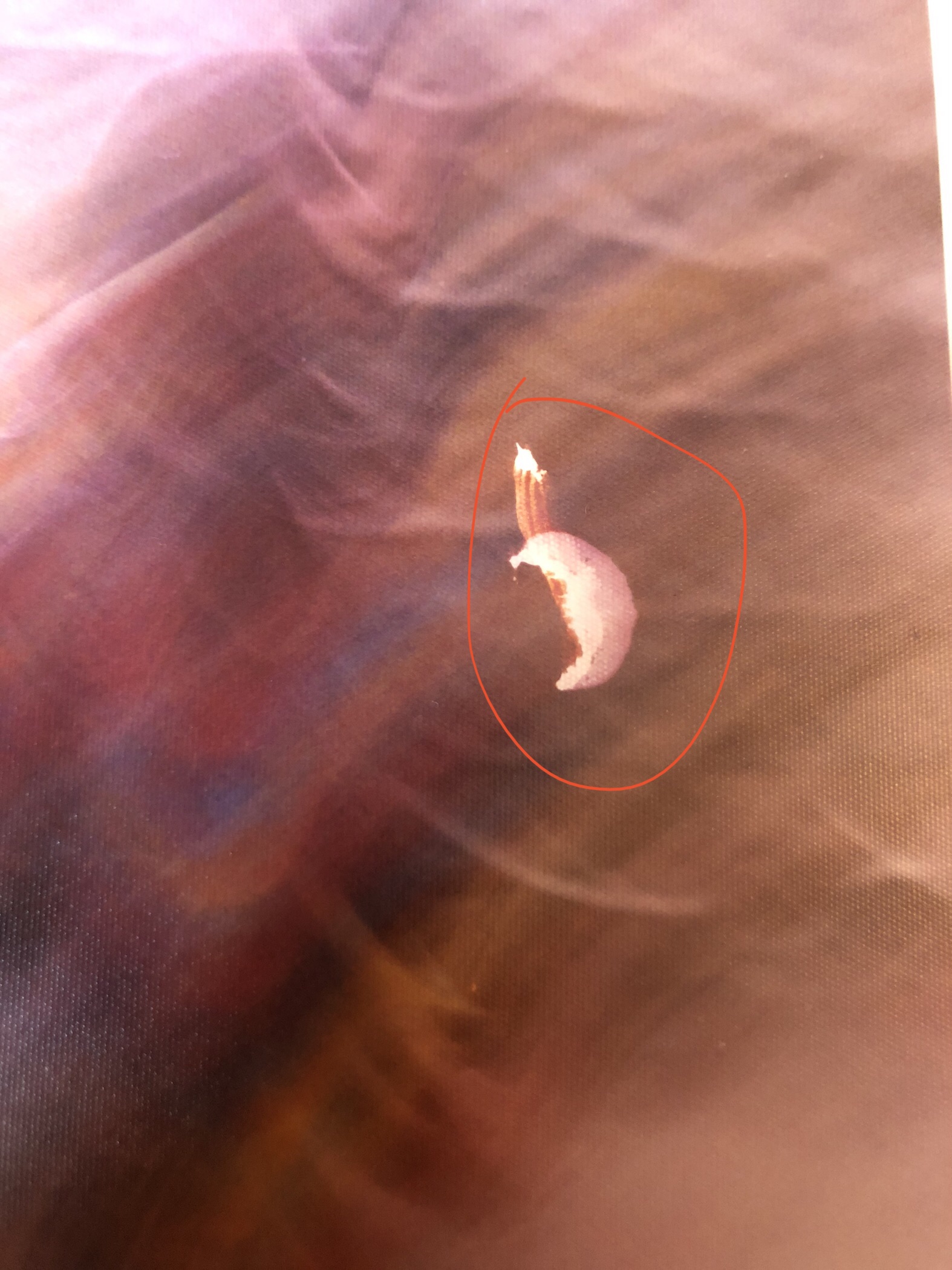

So it was time to do a full print ............... but then I notice these (2 differents prints):
then I cleaned the rolls again and but still on the 3rd print a "chemical stains".
Now for my 4th attempt, I looked closely in the blix bath and I removed 3 little "floating" dust ......and made a print now with emulsion side up and ...........this one work ok (made another 3 prints)
Besides a note-2-myself for further reference and maybe for others not to panic when blue or getting stains, my general question:
What causes the chemical stains and how do you prevent them??? Any tips on how to keep the rollers as clean as possible?
Oops...NEVER store the machine without thoroughly rinsing (and preferably air-drying it) first.
I'd start by properly (not for you, but objectively) cleaning the machine.
Tx and yes, I have cleaned up the rollers and will use the machine hopefully in the coming week again.
i really thought I had cleaned the rolls good 6 months ago
btw: any suggestion what to use for cleaning the rolls? I read about toilet bowl cleaner (= bleek in the Netherlands, but would a mixture of soda+vinegar do the same?)
