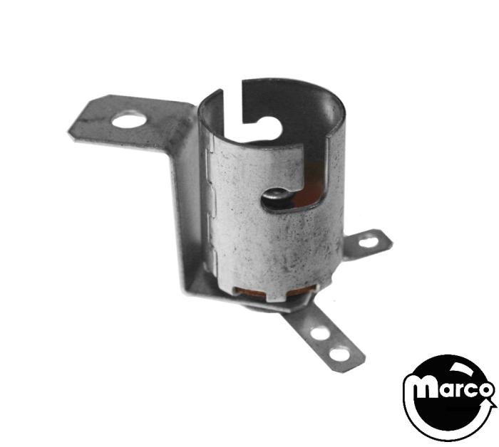

Thank you. It has rotational play to begin with but I can't detect any movement on pushing it. If I rotate counterclockwise until it stops, pulling has no effect. If it's corroded, I suppose I have to replace the socket and lamp which seems like it would involve splicing the wiring somehow. I'm no electrician!
AgX
Apr 5, 2007
29,972
Germany
Basically this is what all those sockets look like:
Julie McLeod
Julie McLeod
Dec 16, 2015
259
Ottawa, Ontario
That's useful. So, if the bulb is having play without being able to push, then maybe it's really already rotating on that horizontal slot. I'll try some more and ask my husband to have a go at it too. Thanks.
