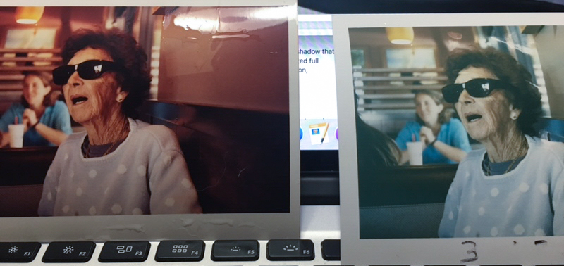

I'm having a problem with my RA-4 printing and I'm not sure what it is.
My prints all have a hazy look to them. I am printing on two different types of roll paper and using different lenses. I did find that one of my lenses had some haze in it so I had that lens cleaned but it's not that. (not entirely anyway.)
I then thought it was the last few rolls of film in a certain camera and so came from foggy negatives so I went back to a known good/sharp negative and printed that, but it also has this slightly hazy look to it.
So I put a bit of Benzotriazole solution into the developer and it seems to be helping though not dramatically so, not like "whoa!." The prints are less hazy but not to the degree that they've gone back to being the way they were several months ago.
The edges of the paper have been 100% clear, no tinting or discoloration, it's just that the prints are most definitely hazy looking; not snappy.
The ONLY other thing that I can see that happened between then and now is that my enlarger bulb blew and I had to re-do my calibration to get proper colors and this is the FIRST time that I've had to use Cyan and Magenta instead of Yellow and Magenta to adjust the color. All of my previous printing has ALL been a combination of Y and M.
So is this just a basic fogging problem or something else

Is there a chance that this is aged paper? I have inherited a huge stash of very old RA-4 paper, and while fogging is negligible, there is a profound loss of contrast, very much like what you show here.

The paper does not appear to be foggy. The edges do not show typical fog. However, the low contrast is what strikes me. It is either the film or the paper process. That is a guess without knowing the details of the entire workflow without seeing the film as well.

Thanks everyone, the iphone didn't reproduce well, the edges aren't colored at all. I'm now wondering if it's the paper process. I'll investigate.
