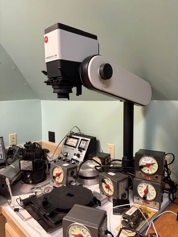

I just bought a Leica V35 enlarger in what looks like very good condition. However, I cannot get it to power on.
Any suggestions or should I just part it out?
Thanks
tokam
Nov 7, 2008
589
Sydney, Aust
I had a V35 about 12 years ago which wouldn't fire up. Turned out they have a slow-blow fuse in the power supply which had died. A new fuse and it was up and running again. I lost access to my darkroom space so I sold it on. Not sure what the situation is for the enlarger bulb they used as it was difficult to source a few years ago. Others may have current info on the bulbs.

Thanks for your reply and advice. I will check for the fuse and bulb. John
