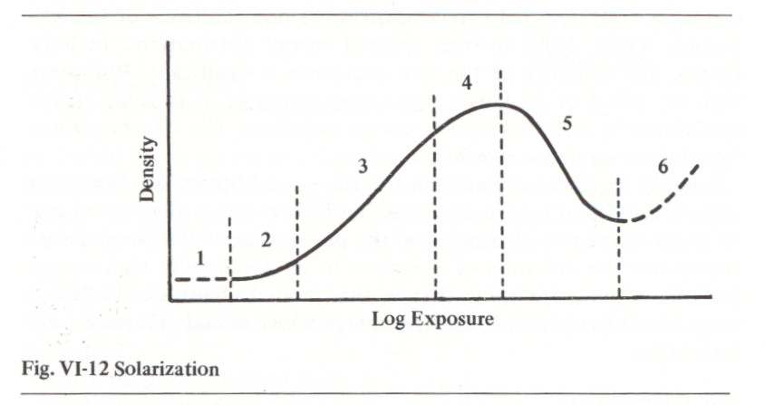

True solarization takes a gross overexposure in camera. Maybe 1000 times or 10,000 times more than usual exposure.
This is a graph showing theoretical solarization curve from Todd-Zakia, Photographic Sensitometry.

It's extreme overexposure and then process as normal.
Different films will behave differently you will have to test. @BAC1967 used a special film.
But you can see he's doing a whole minute at f/2.8 in broad daylight to get into region of reversal (part of the graph number 5) with that particular film.
