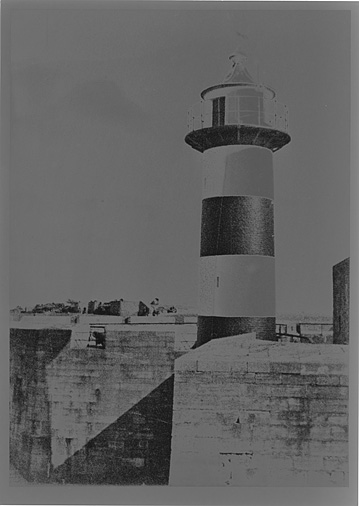

Sabattier success!
Rik,
How did you get on with your Sabattier prints ?
I struck lucky almost straight away (the first two attempts were of the coal in a dark cellar school) once I got the illumination level of the flashing lamp tamed by bouncing it off the ceiling.
I've attached a couple of the results, with the original straight print for reference. It's very grainy and covered in scratches because it's from the first ever roll of 8x11(mm) minox film I used. Interestingly the second attachment with the more subtle, less reversed, effect has magically removed alot of the grain and damage marks, although admittedly the midtone detail has also been lost.
I used normal Ilford multigrade RC paper exposed at grade 4 and normal Ilford universal multigrade developer at the box dilution. I used a 60w 'pearl' bulb desk lamp for the second print, the first more contrasty one used one of the blue 'daylight' bulbs. As usual scanning and low resolutions jpeg files have lost a lot of the magic from the real print - it has an almost metallic look to it.
Crispin

The longer you let normal development go ahead before the Sabattier exposure, the more contrast in the positive image, and the more impact you get from the negative image. You also get better line effects.
On a 2' development time, I typically develop for 1'30" or more before re-exposing.

Latest experiments
Hello all,
I've ordered a bottle of Solarol. From reading the first half of the William Jolly article it seems that a Hydroquinine free developer will give better contrast and 'brighter whites'. Anyway, the Solarol hasn't arrived yet, and I'd always wanted to try a coffee developer, so I mixed up some coffee, washing soda and vitamin C powder according to Donald Qualls recipe. I thought that since reports of Cafenol taking about 5 or 6 times longer to develop film I'd have a similar longer developing time with prints and as it didn't have hydroquinine in it might work well for Sabatier. In fact it worked faster than my normal Ilford Multigrade Dev and gave good contrast! because of the short dev time there wasn't any stain to speak of either.
Having established a good (if quick) normal development I then tried some Sabatier. This is where things got wierd. With the standard developer I had to bounce the light of the roof and use a very short burst, with the cafenol the paper became very insensitive to light. At first I put this down to the opacity of the cafenol, but even wiping the print clean before flashing I was still having to use a ten second exposure, directly over the print (about 3-4 times the brightness of previously).
I couldn't get any reversal as such, any part of the paper even slightly exposed under the enlarger stayed normal, but pure white areas darkened, but also took on a noticeable brown stain. Maybe I need to use an even longer second exposure ? The other problem is trying to wipe the print clean before the second exposure without it going streaky. I tried a quick wash in water but that just halted any further development, even when I put the paper back in the cafenol and agitated alot.
Attached is the best print, not up to Bob Carnie's standard I'm afraid (those are great images Bob!) but shows the effect I'm getting. I might try it with an image with more white in, I used the same image as before so I could compare with my previous efforts.
P.S. Photo Engineer, you said you have posted some Sabatier/solarised images, but I can't find them on APUG. Can you point me in the right direction as I fear I might be being a bit fick.

Most modern papers contain developing agents in them. Many mistake the action of caffeinol as the combined action of the incorporated developer and the caffeinol which is very very weak. So, when the developing agent is washed out, the development comes to a halt.
At least, that is one simple possible explanation.
