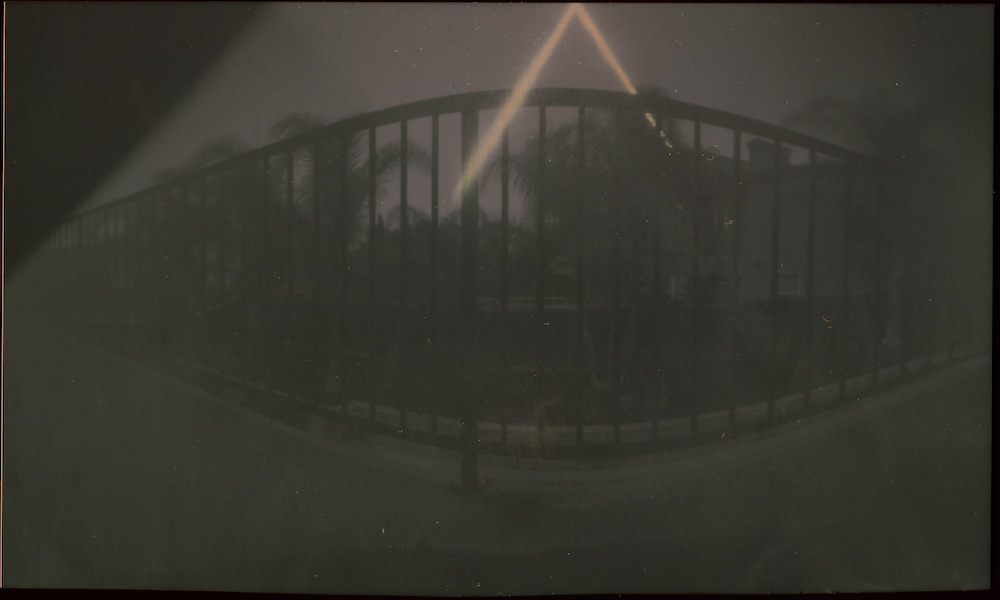

attachment.php
That's my two day long exposure from my backyard... 7x5 inches.
This stuff is fun, I am going to find inconspicuous places to start doing more of this...
