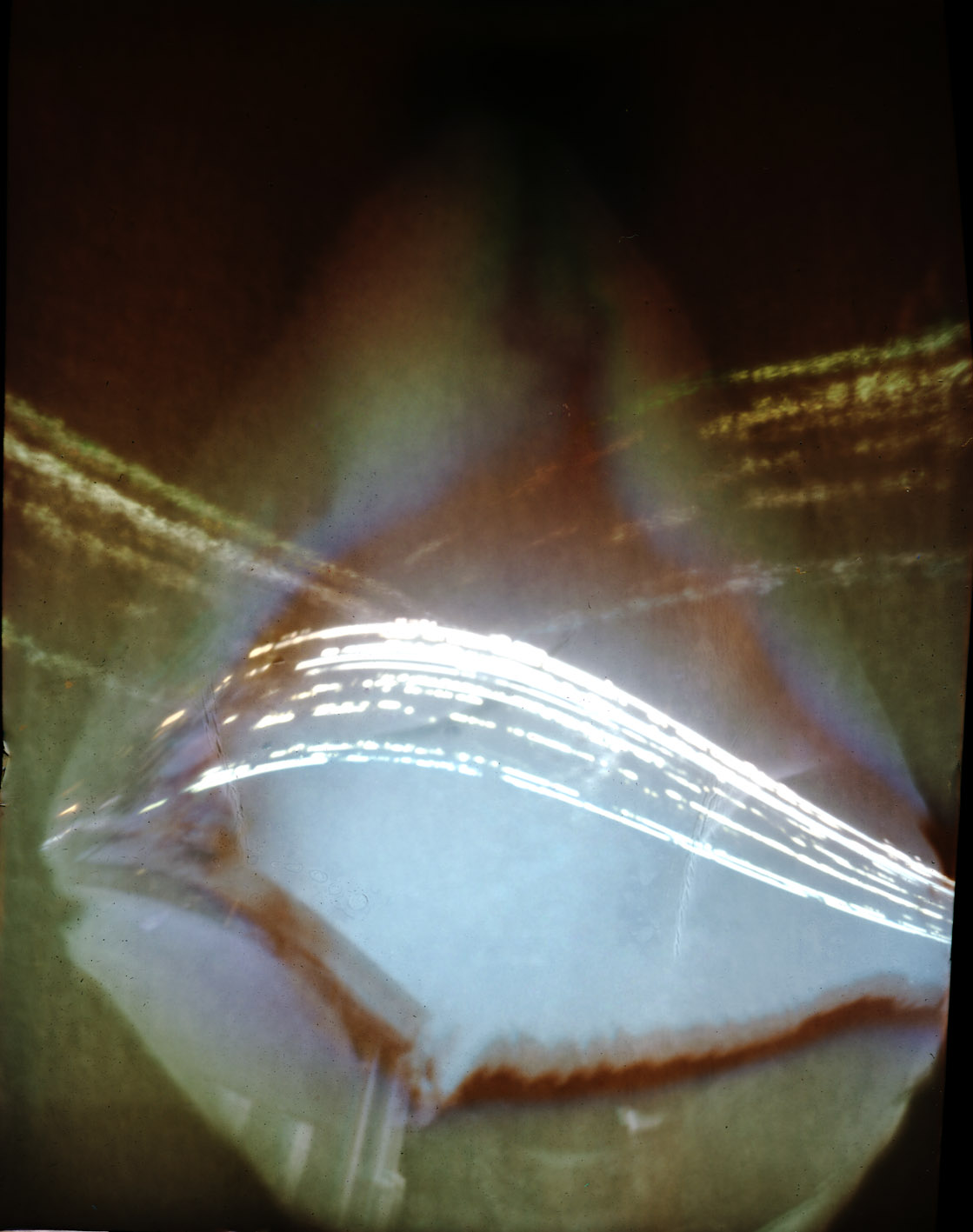

I hope you know the idea of solargraphy , where a pinhole camera is put outside and it records the path of the sun over say 3 months. Below is one picture South_Sun that gives the Sun's path over a few months. Photographic paper was used.

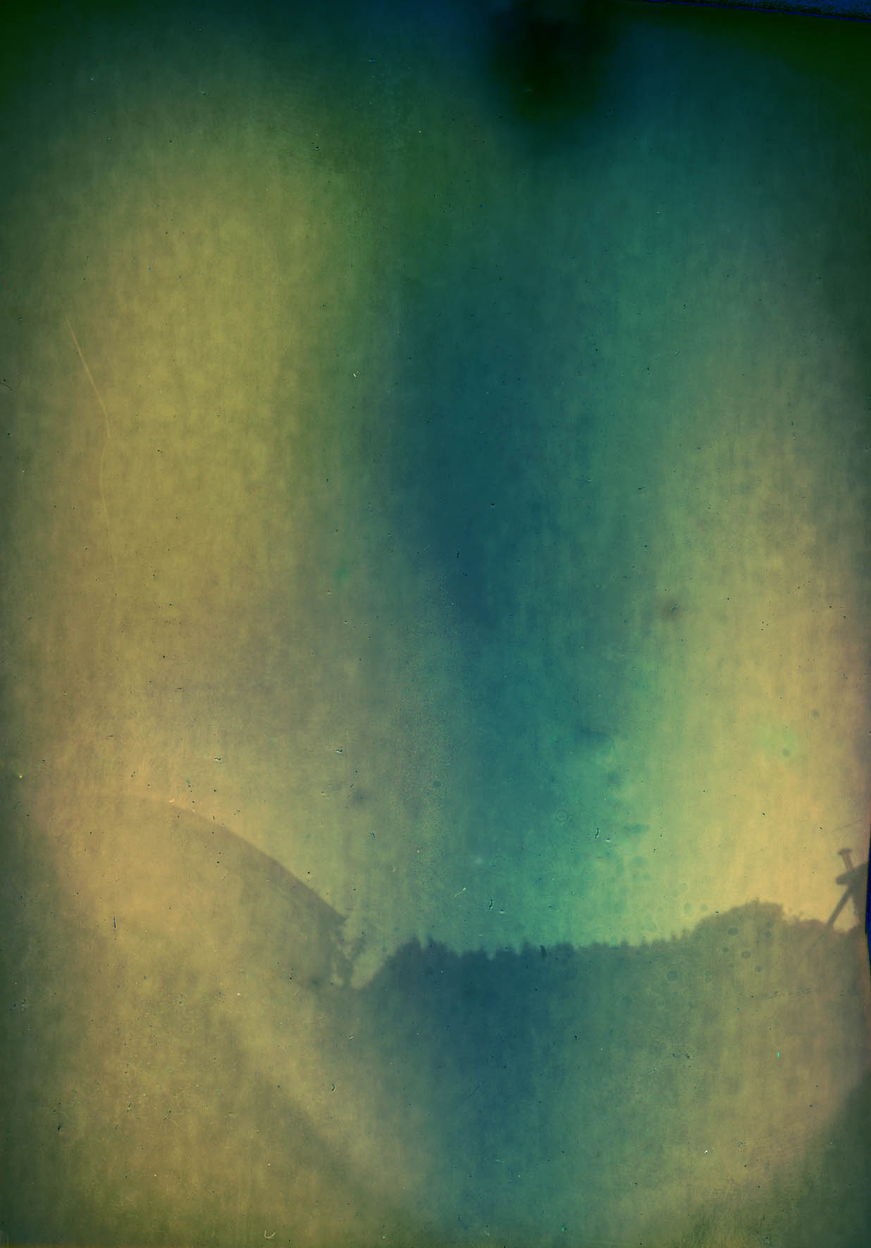

I would also like to do this for the Moon's path (lunargraphy). What I did is that I covered up the pinhole during the day and only 'opened' the camera when a Moon would be visible (some 14 nights).
You can see in the other picture (South_Moon) that nothing is to be seen, while I am sure the Moon was there)...
So the question is, is the paper sensitive enough to expose properly? The Sun is well visible on the paper and say the paper is around ISO 10 to 25. The Sun would expose one particular point on the paper for around 2.5 minutes (due to its width of 0.5 degrees and its movement). The Moon is some 400,000 less in brightness (18.4 diaphragm steps). So what paper sensitivity is needed to get a similar picture for the Moon (or should I use film with what ISO?).

unless you has some sort of lens that focused the moon on the paper, i think the brightness of the moon
might have just "fogged" the paper.
perhaps if you rig a secondary glass / meniscus lens on your pinhole camera that can slide into position
as the pinhole slides out of the way, you will be able to get an image of the moon as you expected. they suggest the "perfect"
exposure of the moon to be "sunny 16 " ( full moon ) so it will be a short exposure ..

what victor wants to do is different than what eric renner did.
eric renner made a 7 pinhole camera and used it to make a relatively short exposure.
then processed the paper. what victor wants to do is leave his pinhole open for such an extended period of fime
that the image of the moon "stains" the paper and creates a solar(lunar)graph. the paper isn't developed ( or it will turn black )
and it can't be fixed ( or it turns white ) ... it is ephemera ... and it has to be skanned, or rephotographed or xeroxed ...

Did you notice the whitish paths that are to the edges of the jpg picture (and outside the projection/contour of the pinhole on the paper).
I think this is due to a water drop on/in the pinhole acting as a lens.
