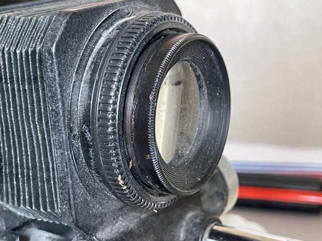

Anyways, today I was cleaning up 45cm APO Tessar #2 which came in a junk box of old lenses, a box lot, and it cleaned up spiffy, but then I was curious and put it on the 2D with full plate back on, and took the front group off. The rear group alone is as fine a soft focus achromatic meniscus as I've seen anywhere. 11" focus and f5.6. I can't help myself, I get so tickled watching a Hyperion break the $3k ++ price mark, and I'm happy it did, because I've got one, but if you've got a worthless old 45cm APO Tessar go take the front off and make some softy pictures.

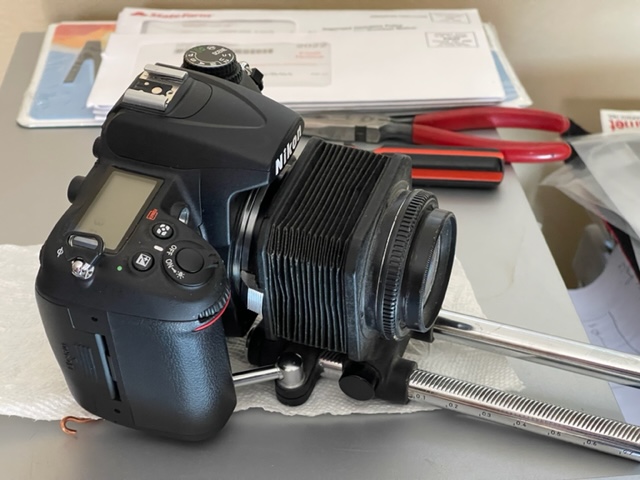

Any tessar has this capability. I have the rear group of a common as dirt 7" Ilex tessar glued to a hollowed out Nikon body cap that I put onto a Nikon bellows and shoot beautiful soft focus color images with my Nikon D7000
