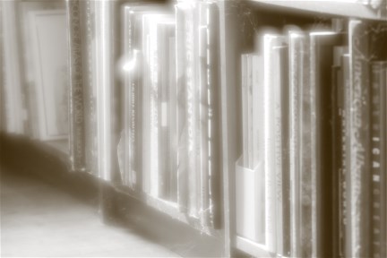

Soft Focus lenses achieve that look by using uncorrected spherical aberration. This means that the outer part of the lens focuses at a slightly different plane than the center part of the lens (which is what a spherical shaped glass surface does, hence the name). In essence, there is a sharp image in there, mixed in with some out of focus image, which gives the highlights the glow.
A mesh type soft filter generally add veil, which lowers contrast and hides fine line. You don't get the same glow in highlights.
A lenslet filter (like the Hasselblad softars) embeds lenses in a flat resin matrix, allowing it to mixes in an out of focus image. This approaches the effect of a soft focus lens, and hence it is the more desired soft focus filter for professionals. A dedicated soft focus lens incorporates a continuous range of out of focus image components, whereas the filter's lenslets have only one out of focus image.
In theory you can mimic this by taking an in-focus and an out-of-focus images and mix them together - but you need a good cine lens that does not breath when you change focus.
There are a few different approaches to achieving a pleasant soft focus image. The sick strainer filter is meant to function as an apodization element, controlling the out of focus component from the periphery of the lens. The Rodenstock Imagon work this way. The Leica Thambar works the other way, the bare lens has only a small amount of spherical aberration, and they supply a center spot filter to block out the sharp center part it increase the soft effect.
Whether the subtle differences in the soft look are worth the trouble is up to you, but some of the soft focus lenses are pretty inexpensive, some not. Usually their is a reason for this price discrepancy, but I think the differences are pretty subtle.

Keep in mind that the trick that real soft focus lenses do is to overimpose on a sharp image, another image which is more or less soft. The softness is controlled by the aperture, or by specific scolapasta slip-in diaphragms. This effect is, in general, not achieved by placing net or fabrics over the lens, or by applying hair spray over a filter, as the entire image will be softened and there will be basically nothing really in focus (which may be OK with some images, but it's a different thing nonetheless)
The Zeiss Softar somewhat imitated the behaviour of a soft focus lens, as the filters are almost flat with occasional small domes here and there, so the image will be composed by a perfectly focused image (passing through the "flat" areas of the filter), over which there will be superimposed an image defocused by the domes. However, the soft-focus effect can not be controlled by the diaphragm: it stays more or less the same at all apertures (which may be either a flaw or an advantage, it depends). As already said by others, these filters were unreasonably expensive when new. All Zeiss gear has always been terribly expensive, but these filters were expensive beyond reasonable.
Filters made with lines will also create a focused + defocused image composition, but these were mostly introduced in order to get those cheesy, kitsch "starlight" highlights that seem to appeal so much to uneducated brides and newlyweds. I would definitely rule them out, unless for some reason you would like / need to get this horrible artifact.
Coming to the Soft focus lenses you mentioned, the 120mm for Pentax is too short for portraiture in 6x7 in my opinion. It's even shorter than the 127mm that Mamiya offered as a "normal" lens option for the RB system. Unless you're working in a very narrow studio room, I would rule it out.
The Mamiya and Fuji both imitate the much celebrated Rodenstock Imagon system with its distinctive scolapasta style diaphragms, and their focal length is quite all right in both cases. I would personally go for the Mamiya because their scolapasta has very fine holes that mask a bit the strange (or "characteristic") behaviour that these lenses show on point highlights. I never used a Fuji soft focus lens, so I will just report that they have mixed reviews: some claim they're excellent, others say that they are soft at all apertures and that basically there is never anything really in focus under all conditions. But again, these comments are not mine and may be rubbish in one way or another.
As a side note, keep in mind that Zork also made a "tubus" with which a true 200mm Rodenstock Imagon could be installed on a Mamiya RB 180mm shutter assembly, by unscrewing the front lens block.
In any case, whatever you will buy, just check twice that the lens will come with its COMPLETE set of scolapasta diaphragms. Some (or all) of these are very often missing from the kit, and finding a spare is a mightmare.

A softar filter is as close to true soft focus as a fog filter is to real fog. Not.
A soft-focus lens produces a sharper image overlain by a more diffuse image. By varying the aperture (and perhaps softness degrees set independently such as the Minolta 85mm Soft lens), the ratio of those two images can be varied thereby producing a sharper or softer image. This is not analgous to a soft focus filter which simply destroys resolution. Furthermore, one of the key effects of a true soft focus lens is an apparent increase in depth of field, again, nothing like a fuzzy filter. As the soft focus lens is stopped down and the spherical aberration decreases to nearly zero, it becomes well-corrected and functions like any other sharp lens.
I find the Mamiya 145mm Soft Focus lens to be excellent but tis for 6x4.5. For 6x7, The Pentax 120SF is a pretty good soft focus lens. I shoot both the Mamiya 150 and 180 soft lenses, with and without the "tea strainers," but on the whole, don't enjoy their signature look as much as these two prior lens. Your mileage may vary considerably as this is personal perception. IMHO, most modern users create images that are far too mushy ...
If ypu have curiosity and patience, you might want to browse my doctoral thesis (University fo St. Andrews, 2008) about soft focus lenses: https://research-repository.st-andrews.ac.uk/handle/10023/505
