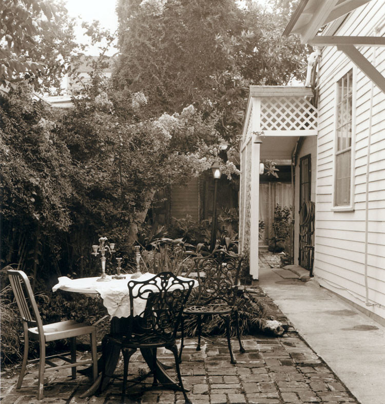

I did mix full strength toner to try with Arista Private Reserve RC Pearl, aka (most people think anyway) Adox MCP 312. It responded in the weak toner but I didn't like it. It was an odd reddish brown that I didn't care for, and took a lot longer than MGWT. I think anything takes a lot longer than MGWT. I mixed full strength and got a pretty nice chocolate brown with 10 minutes of toning. I can scan that if anyone is interested. It's a cooler brown than you'll get on a warm tone paper like MGWT. The red tone I didn't like I got after several minutes in the very dilute toner. When I mixed it full strength I just put the same print in for another 10 minutes so it's hard to say if it's faster with one or the other. It's different, though.
Here's what my toning looks like on MGWT with 50 seconds in the 1/8th strength toner, for a light toning effect I like very much:
Dead Link Removed
Dead Link Removed by Roger Cole, on Flickr
Here's the same paper, otherwise same processing, but toned for 40 seconds in 1/4 strength. Considerably more toning than the 50 seconds at 1/8th:
New Orleans Courtyard - Toned by Roger Cole, on Flickr

I like your examples Roger. Although they all look quite different in terms of toning, they do share the same understatedness.
My two prints from today (12x16", too large to scan) are way way overdone compared to yours. I will take your 1/8-dilution, twice-the-time method as a starting point for further play; will have to start somewhere anyway.

I was in fact looking for a fairly subtle effect. I don't like the slight green cast of un-toned warm tone papers. I wanted something warmer for some subjects, but far short of full on sepia toning. I find strong toning, while occasionally useful, to more often just look overdone. This is entirely my artistic judgment and taste and need not be anyone else's. :wink:
The New Orleans courtyard scene is actually an "overtoned" one that resulted in my trying the 1/8th strength in an attempt to gain more control and prevent accidentally toning more than I intend. I meant it to be far more subtle, and have a more subtle one on my wall. But that's about 10x11 or so (slight crop from a 6x6 negative) on 11x14 paper and I couldn't scan it, so I made an 8xwhatever one that I could, and it got away from me a bit and became a lot more toned than the one on the wall. I sent that one away on a print exchange over on FADU. Most people seem to like it this way, though, so I left it in on my Flickr page.
For the shot of my wife I wanted more full toning. The combination of evening sun and the wood of the park bench I thought would work well with a warmer look.
