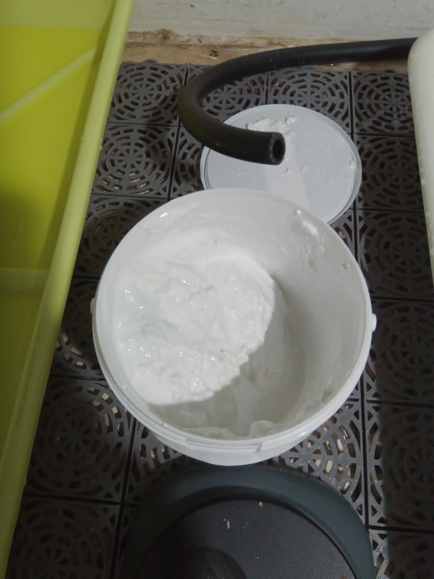

I acquired some sodium sulfide recently on eBay. Rather than the usual yellow flakes like I expected I got this tub full of white goop which I assume is some kind of heavily concentrated solution. I tried it out and it toned my prints just fine and also had almost no rotten egg smell. I could barely detect it.
Anybody seen this before? Is it a normal way to sell sodium sulfide? It came from the EU if that makes any difference.

There is also a crystalline form which is very hygroscopic which readily absorbs moisture from the air and becomes semiliquid. However that stuff looks nothing like what you have. But as long as it tones you seem safe.

I have never seen Sodium Sulfide that looks like that. Does it have any odor? Na2S always has a strong odor.

Here is the response I got from the seller:
There are indeed 2 types of Sodium Sulfide (anhydrate / hydrated) which you mean is the anhydrous variant this form are flakes. These are very dangerous (self-igniting) and may only be delivered with ADR transport. This is absolutely not allowed to be sent by post in Europe.
There is also a dissolved form Sodium sulphide Hydrated also called crystal water (paste) this one you received from us
I looked it up based on the data sheet provided, I believe that it's about a 60% solution with a molecular weight of 78.04. I'm not sure how I would translate that into an equivalent amount of dry flakes. I just dissolved a good dollop of it and it seemed to work.

Well, as suggested above, you might try toning with it. Or, dissolve some in water, say about 1%, and then dip in a piece of photographic paper in the light. It should turn black instantly.

That eBay listing is illustrated with a packaged powder. And yet you received a tub of "goop".
Any chance that the eBay seller sent you something in error, but thinks you got the right stuff when he answers your question?

I was just thinking that a 60% solution of Na2S should literally smell like hell, but if there is only a faint odour, it is probably something different.
Just a speculation now: If it was sodium sulfite, that would explain the lack of smell. And it would render a solution sufficiently alkali to develop exposed paper (the type with the embeded developer).

Wouldn´t it be better to do this under safe-light? AFAIK Sulfide will fog unexposed B&W paper.
Sodium Sulfide rapidly blackens exposed photographic materials and forms Silver Sulfide. If this material does, it proves it may very well be Sodium Sulfide. You can do it in the dark, of course, but the idea is to see it. Under a safelight is OK as long as you can see it.

All a bit strange to my eyes, especially when the listing states: 'The powder is securely packed in two ziplock bags.'
Yeah I wasn't thrilled with getting something other than what I expected. In the end I decided I was OK with it although I did suggest the seller update his listing.
I was just thinking that a 60% solution of Na2S should literally smell like hell, but if there is only a faint odour, it is probably something different. Just a speculation now: If it was sodium sulfite, that would explain the lack of smell. And it would render a solution sufficiently alkali to develop exposed paper (the type with the embeded developer).
It's definitely sodium sulfide. I used my normal sepia toner bleach and tone process and got the same results I would expect from using dry flakes. It's a very strange looking paste but it does work.
