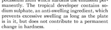

In this article about astronomical photography (1956) there is a statement that looks to me as though the sodium sulphate will wash out. Little screen shot below, I couldn't copy the text.
