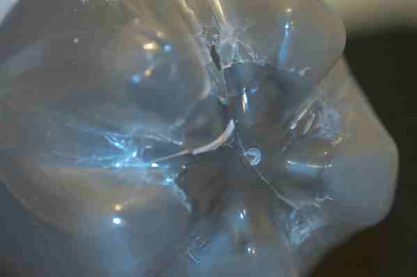

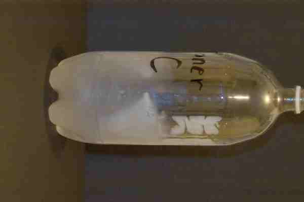

I have been used empty soda pet bottles for chemical storage, they work well, they’re flexible and have great resistance to gas permability.
Mixing up some thiourea toner, I mixed the sodium hydroxide and after cooling stored it in a 2L bottle. Sometime later, when using the chemical, I noticed it was leaking. Draining the bottle, I could see that it was etched. And a large part of the bottom was cracked. Even though I used plastic to avoid etching a glass bottle, it would be safer than to use another 2L pet bottle.
I have seen many recommendations to use store NaOH in plastic bottles, has anyone else seen anything like this.

Actually was only commenting about the etching. Etching glass however is documented, see Wiki for example.
The problem was the cracking and resulting hole in the bottom of the bottle. See pic 2. It could be the 5 dimples and crystal formation causing the cracking. Any comments.

I was surprised by that bottle breaking. I looked up some lists on the stability of PET and I learned that it is somewhat resistant against weak alcali but non-resistant against strong alcali!
These lists are often not very practible, but what I learned make me think that PET should not be used in the darkroom.
Beside the issue of storing a real hazardous chemical in a drink container...
