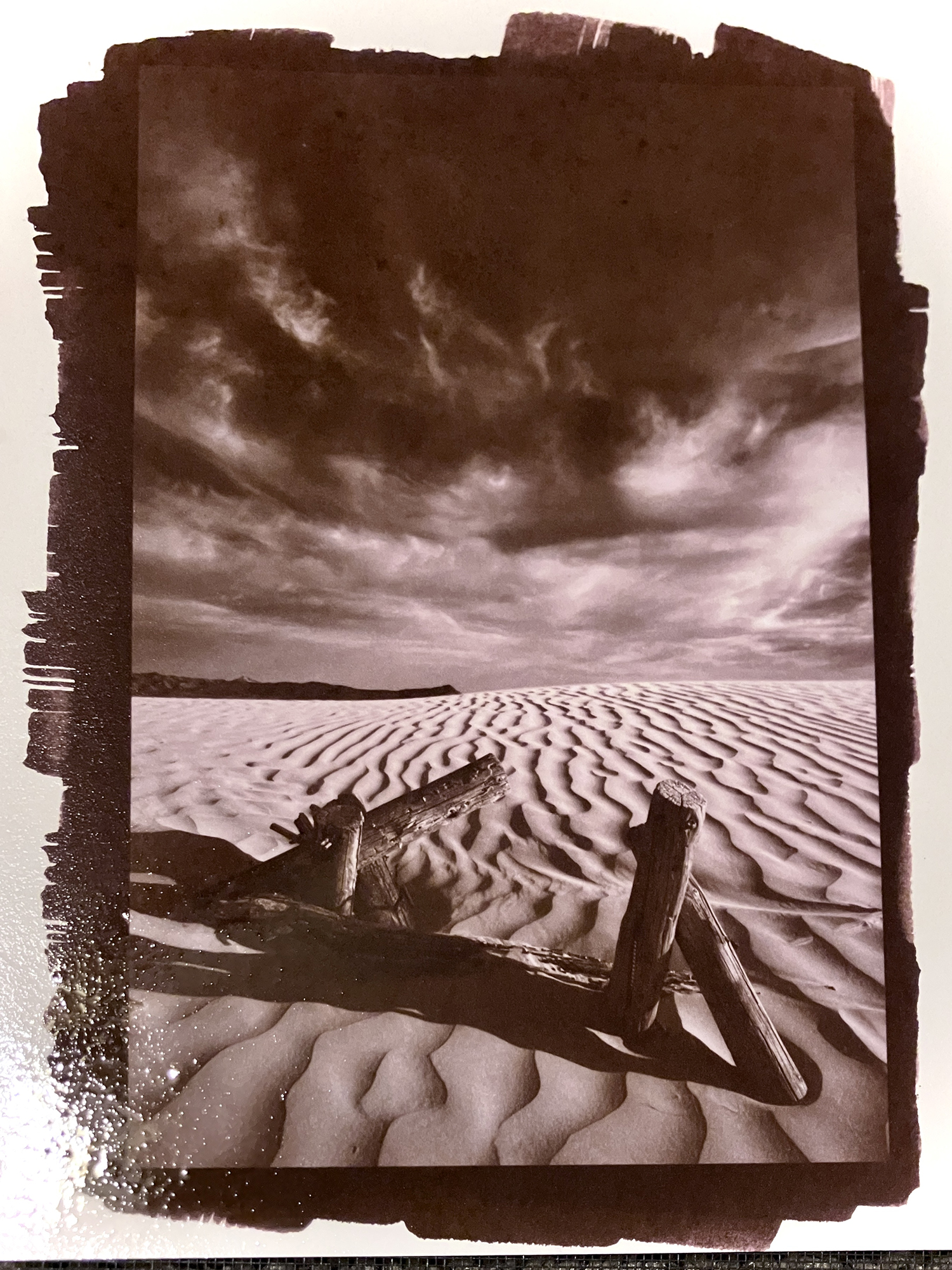

Wanted to report back here now that I've made several prints, and iterated through a few different tone curves in Photoshop for converting my files to inkjet negatives on Pictorico. I didn't end up needing to play with dichromates (phew), and I think I'm getting a full range of tones between a fairly decent dmax and paper base white. The trickiest part is achieving a good dmax and a true paper base white at the same time as getting good shadow tone separation. In most of my earlier kallitypes, the shadows get muddy and bleed into each other really fast. Adding a substantial amount of contrast to the shadows and a somewhat lesser amount to the highlights seems to have been the ticket for me.
I also had to re-build a few parts on my DIY contact printing frame. I wasn't getting perfect contact, and it was resulting in noticeably soft/blurry areas on my prints. After tightening some things up, I can no longer detect any spots that look out of focus.
All together, I'm really thrilled with the results I've been getting. Pardon the phone picture of a still very wet print, but I think this is the best kallitype I've made to date, so I wanted to share. Thanks all for your expertise and help.
Andrew O'Neill
Jan 16, 2004
12,057
Coquitlam,BC Canada
That’s basically how these look before they dry. I’m gold toning, so when they dry down they get a bit darker and shift to a fairly purple color. While still wet they’re more pinkish brown.
Are you gold toning before or after fixing? I get a pinky tone if I gold tone after fixing...
Andrew O'Neill
Jan 16, 2004
12,057
Coquitlam,BC Canada
Before fixing, after clearing.
Here’s an actual scan of the dry, flattened print that shows its final color.
Now that I like! Beautiful!
revdoc
Apr 12, 2015
291
Nice image! It looks like you're getting some spotting or uneven tone in the sky. Which paper are you using?
BHuij
BHuij
Oct 12, 2016
867
Utah
I noticed that too. The paper is HPR. I believe that the spots are indicative of either insufficient brushing, or insufficient drying before I exposed the paper. But if you have ideas for what might be causing it, I'm all ears. The spots are not on the negative. I made a second print from a different negative last night too, and gave it more dry time, and did not get spots. All the ones I've made over the past few weeks have also been spot-free.
BHuij
BHuij
Oct 12, 2016
867
Utah
I don't think the dmax or the contrast came down significantly, other than what you would normally expect a wet print vs a dry print to look like.
That said, it's entirely possible that the iPhone pic shows higher contrast than the scan. When I took the iPhone pic, I tried hard to get the color balance and white/black points to look on my screen the same as they did on the real life print as viewed under a daylight balanced bulb. And when I say I "tried hard," I mean I used the sliders for 30 seconds.
Same story for the scan. I held the dry print in front of me and tuned the (very flat) scanned TIFF using a levels adjustment layer until what I saw on the screen felt like a faithful reproduction of what I was seeing in the print in real life. I put more effort into this than I did with the iPhone pic. But I'm sure neither digital representation is a perfect match for what the physical print looks like. If for no other reason than that screens are backlit and prints are not.
I guess what I'm saying in a lot of clumsy words is, the real life print did not lose dmax or contrast when it dried, and when I adjusted the phone pic and the final scan, my goal in both cases was honest reproduction of the physical print when setting black/white points and color balance, rather than artistic interpretation.
