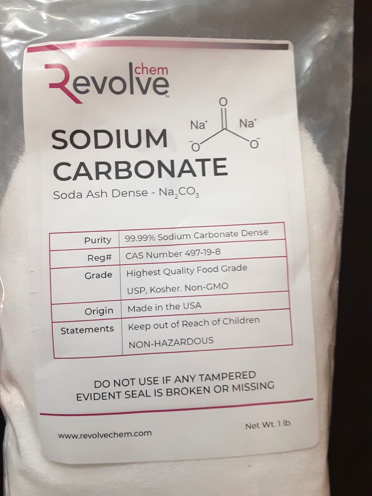

I purchased this from the internet, thinking it would be labeled indicating either mono or anhydrous. But it isn't. Plan on mixing up some D72. The label states dense, but that means nothing to me. The photo shows the only label on the pack. Any help is greatly appreciated.

According to the CAS number (497-19-8) it is anhydrous.
Bingo. Georg's got it.
Regarding the "dense" aspect of the name: For crystalline substances, this is generally an indication of physical form. A "dense" version typically has a coarser, sugar-like texture that has a higher bulk density, whereas a "light" version will typically have a finer, flour-like texture with a lower bulk density. Both versions are chemically identical and can be used interchangeably, with the caveat that the dense version may take a little longer to dissolve.
