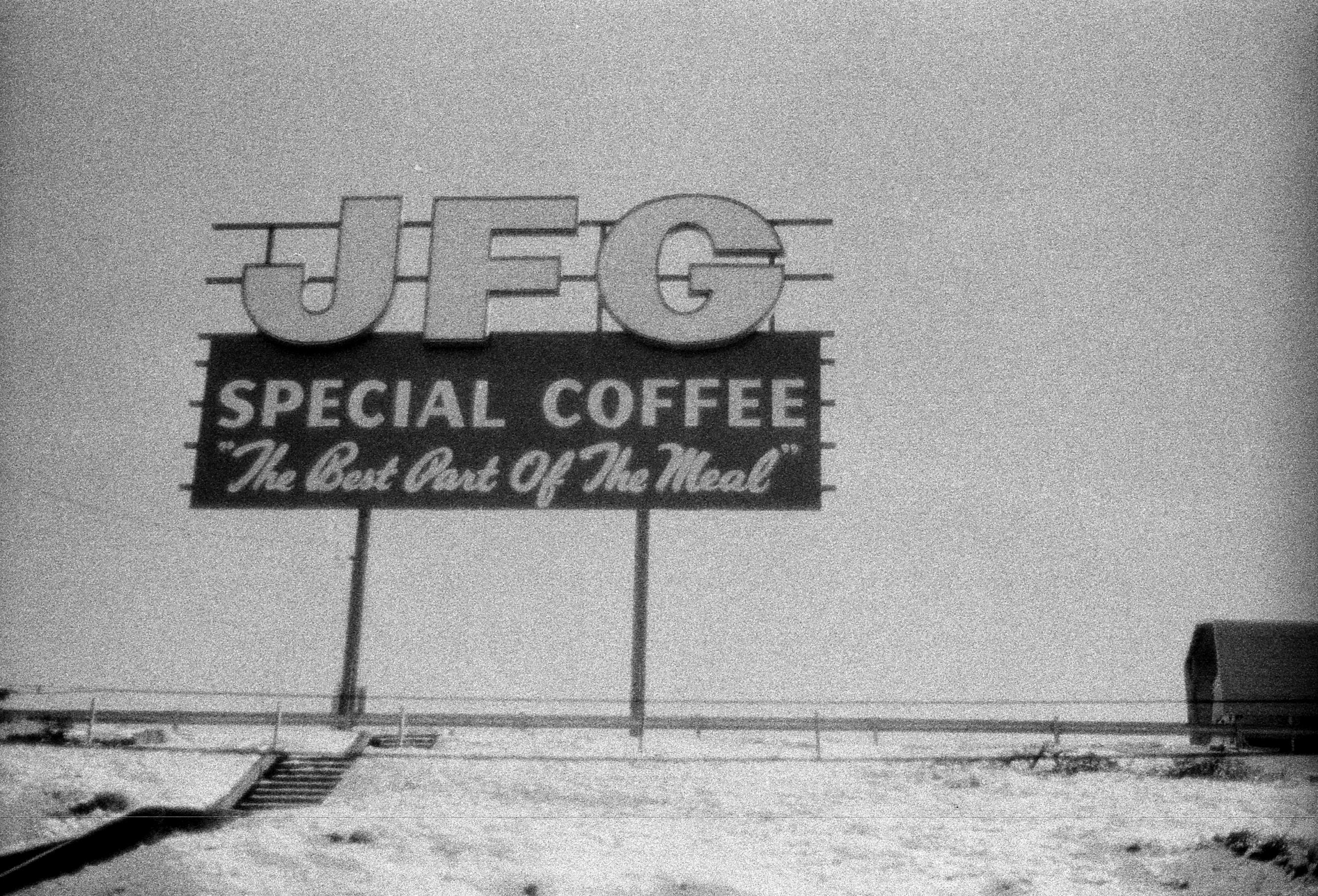

I went on a photo walk this afternoon with my trusty, old Konica TC-X SLR, and shot a fresh (unexpired) roll of Arista.edu Ultra 100. The meter seemed to be working fine but nearly all my shots were overexposed, regardless of the subject or lighting. So I'm guessing my meter is off. More disconcerting is the fact that the majority of images also have an excessively grainy appearance. I'm attaching an example of an image that I adjusted for exposure in GIMP. This is typical of the kind of graininess I'm talking about.
So any ideas what went wrong? A few possibilities enter my mind:
(1) The overexposure created the grainy effect.
(2) The age of my developer. I'm using D-76 that was mixed several months ago, but it hasn't yellowed noticeably, as I've seen with really old developer.
(3) I got a bad roll of film.
Or could it be something else I'm missing? I've used this film with excellent results in the past. 50mm_meetup_09.jpg
Can you test your camera meter with a known accurate meter? Looks like this may be more a case of serious over- development rather than overexposure...you have some serious grain there!
I don't know what film Arista is, but I'm sue that the grain shouldn't be like that unless you have over cooked it considerably.
If your D76 was old the effect would be under-development, making your film too thin.
Couple of questions before I can try to even guess.
What does the film look like? Is it overly thin or overly dense in the image area?
What does the film rebate (outside the image area) look like? I know the numbers are there but is the rebate clear or if you look closely, can you see fairly even coat of what looks like an exposure to light?
You said your D-76 is older but how was it stored? In full bottle or less than full bottle?
Weird looking frame - almost looks infrared. I think the edu film is Foma 100. As Tony suggested, you should check the camera meter against another one, perhaps even an iPhone meter if that's all you have.
The negs look really dark for the most part in the image area, although the rebate area is clear (other than frame numbers and film info). I didn't make any adjustments for exposure, although I got similar results with shots that had no snow or especially bright features (including ones I took in/ of shaded areas). I didn't try using a separate light meter, as I've not had problems with this camera's metering before (I even put in a fresh battery yesterday).

Check your camera to see if the aperture is closing down at the time of exposure and the shutter speeds are reasonable.
One possibility is that a combination of over-exposure and under development (due to expired developer) resulted in very low contrast negs. When Gimp adjusted the exposure, it may also have pushed up the contrast, exacerbating the grain.
You are assuming the meter is faulty, but it could very well be that the shutter is off by 2 or more stops.

Lots of possibilities here.
I would really encourage you to track down the exact cause of this for one (ancillary) reason: There are many in this forum who strive to get the monster grain that you accidentally managed to get. If you figure out how to repeat this (film/exposure/development, etc.), there will be many grateful photographers out there in your debt!
I, for one, like no grain at all, but appreciate the gritty look in others' work.
As for diagnosing your problem; do check your shutter and meter to find out if overexposure is really a factor. If not, then overdevelopment looks likely.
However, if you have underdeveloped negs and are increasing contrast while scanning, that may be a large factor in the grain. Does an analogue print show this grain? If so, then it's not a scanning artifact.

Hard to imagine this time of year, but could the D-76 have been warm?
Agree with above, I like your "accidental photo".
BTW.... I have NEVER had a "bad roll" of film and I used to run 80 a week or more through my gear for years on end.
Miss-handled film is another thing... too many times is the hot trunk, airport scanner, etc.
Developer may have had stuff settled out... check the jug, anything more than a month for D-76 mixed especially with any air in the tank will cause underdevelopment... (my experience)
