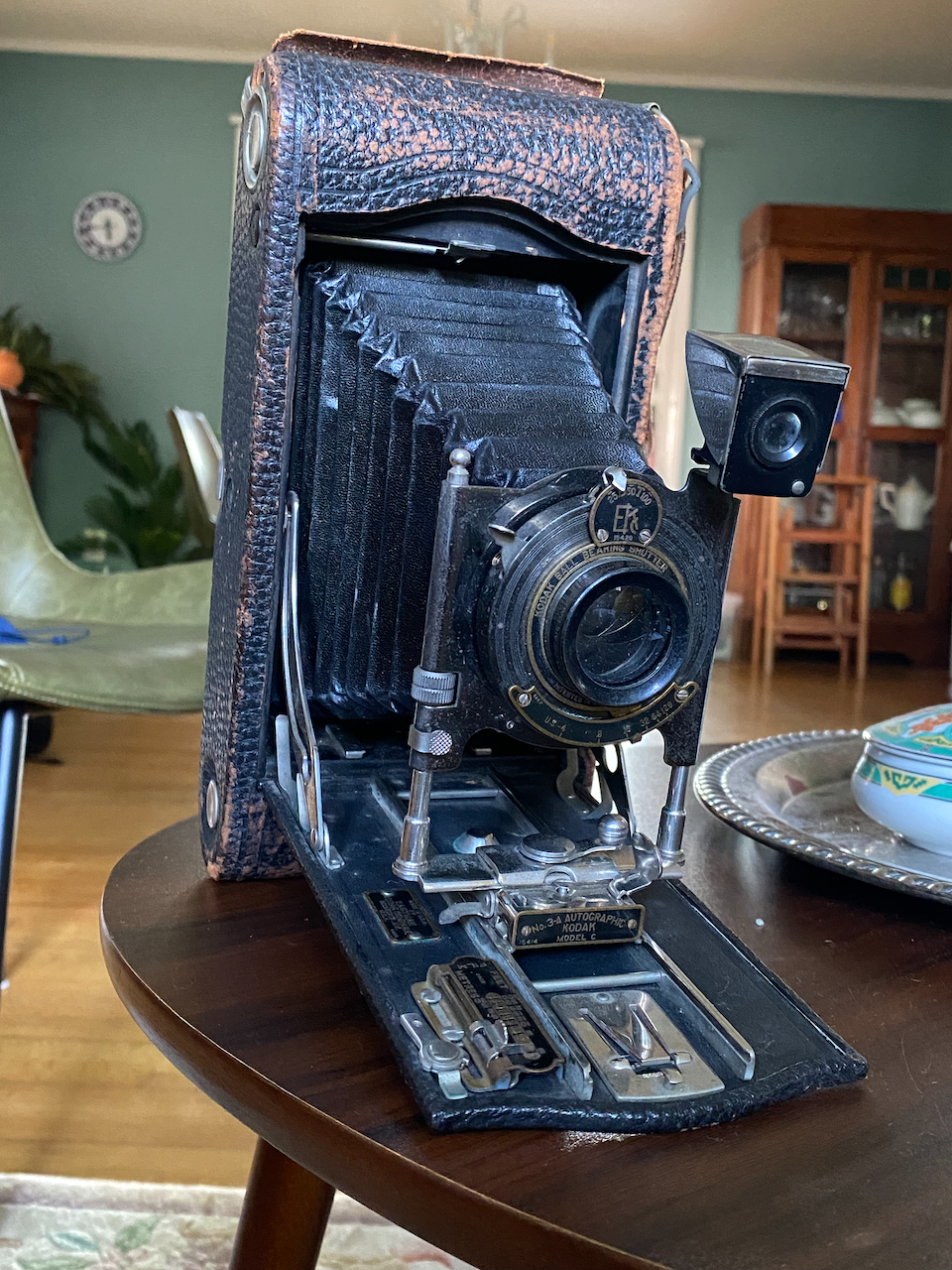

Was just given this as a gift. But --- what is it??? Film looks like 120 with elephantiasis.
I have no idea if it works. But, it sure is purdy!

The front standard says "3A Autographic"; does yours have the stylus in the holder below the metal flap in the back?

I have one like it somewhere, in a storage box. An early 20th century relic, pre-First World War. Not worth much as an antique, but an interesting collectable, as someone has posted very lovely in a China cabinet.
The Eastman autographic system was overrated but quite a craze in the 1910s. The old Kodak amateur photo books have interesting information about them. The shutter will probably still work. Clean the lens v-e-r-y carefully. The bellows may be full of holes.
It looks too big to be a 120 'tho Eastman Kodak did make those. Likely an odd size film - 116, 117, 122.
Converting to 120 is fun. Don't expect to get anything in really sharp focus on film with it. Otherwise, an amusing project to clean and maybe restore on a cold winter's day.
A half hour's work with some bees' wax and a little Kiwi or Nugget black boot polish will make that baby shine like new.
Does it have the Kodak Autographic 'pencil' (a small Art Nouveau embossed metal stylus) in its holder at the back? Most don't. Mine did, and by some minor miracle I recently bought a homeless pencil in a charity shop for A$2. Apparently a rare collectable, those pencils.
Enjoy!!

Well, shutter opens and closes. I’d need to tape up the back cover — looks like there would be some light leaks. But — with a spacer like in the referenced thread — why not? Could be fun.

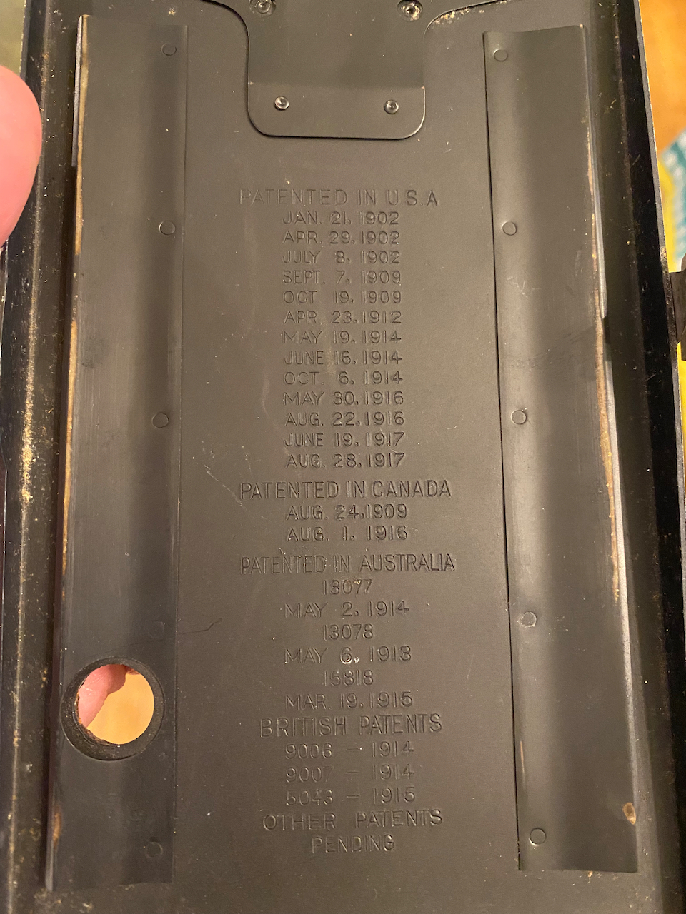

Don't see any stylus, but the back cover at least tells me this was one of the last models:
Google (Camerapedia) tells me Kodak made the Autographic in the period 1914-1927. As you say, it look as if yours is a later model. It surprised me to see the patent info (on the camera back) dating to 1902, long before this model hit the camera stores of that time.
The condition of the inside back cover metal on yours looks good, BTW. About 800,000 were made. This also surprised me. I had not expected so many, Box Brownies yes. The Autographic was a mid-range market camera and not one of Eastman's el cheapo offerings.
You can replace the small round celluloid red window with a home-cut one. I am told these can be bought online. The red window of my camera is pristine. I also have the box and the original instruction booklet, which as I recall is dated 1922. So this may be the date my camera was produced. Like in your case, mine was also a gift, it belonged to my partner's friend's mother who had it put it away in a cupboard for many years. When her mom passed on her things were distributed to family and I was gifted with the camera. Nice.

well, I could replace tge window…or just put some tape over it. Who needs to know what frame I’m on? ;-)
You need to tape over the window anyway… it’s on the far edge of the 122 film, which is not even close to the 120 film and would be an ugly light leak. I established a “start arrow” and counted the number of turns of the wind knob it took to get to film. Then counted the number of turns for each frame. First using an old 120 film backing until I got the counts right.
Good gouge. I was wondering how long it would take me to figure out the spacing. You’ve saved me a roll or two. Thanks!
