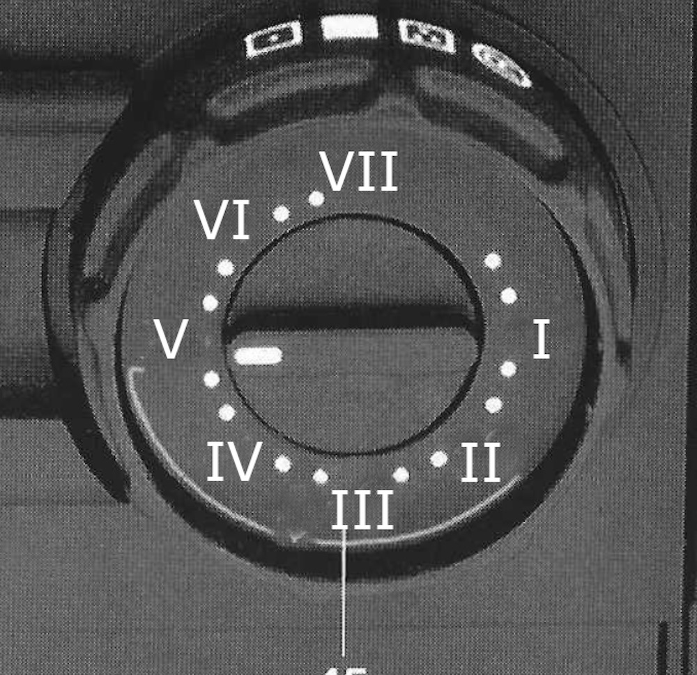

I only shoot B&W negative. I think, to 'spot meter,' one needs some way to interpret the data. On my Rolleiflex, the exposure compensation dial can function as a 'Zone' dial to interpret the readings. Otherwise, with no way to interpret the readings as Zones, a spot reading is not useful unless one happens to find a gray card in the scene.

The spot meter is always V unless you have a zone compensation dial like I posted. So one would need a gray card in the scene's light for proper measurement.
Why? Zones are stops.
