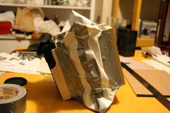

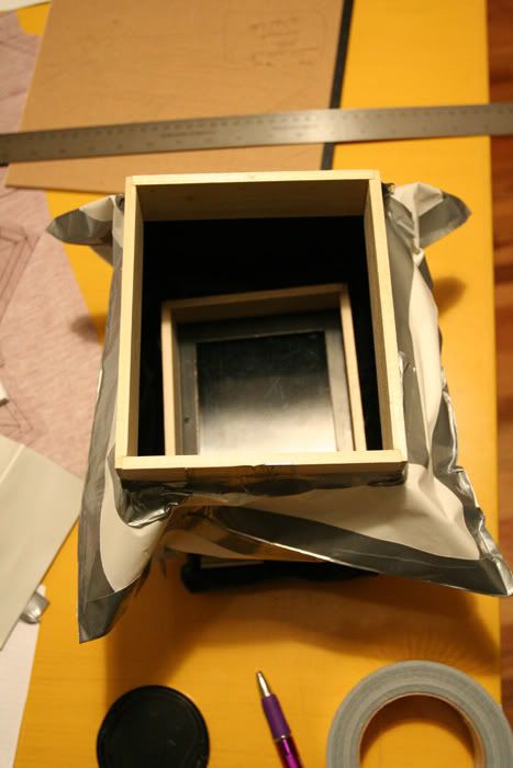

BTW I'm working on a really simple view camera right now. It's just two box frames connected by a bag bellows and eventually a rail. Your construction need not be as elaborate as something like a Zone VI, Tachihara or Shen Hao. Anything that connects your film holder with your lens in a light tight fashion and allows movements will work. Here's mine with the prototype bellows installed (the real one will be flexible cloth instead of photopaper black-bag material). The rail will be very simple and allow movements on just one axis, plus focus:
http://i23.photobucket.com/albums/b377/walter2323/IMG_5573.jpg
http://i23.photobucket.com/albums/b377/walter2323/IMG_5575.jpg
This is just a cheap 'n dirty camera to throw in the canoe on trips, take on higher altitude hikes, etc. The film holder is a 12-shot graflex bag magazine. Kind of dusty but much smaller than the equivalent number of real holders.
