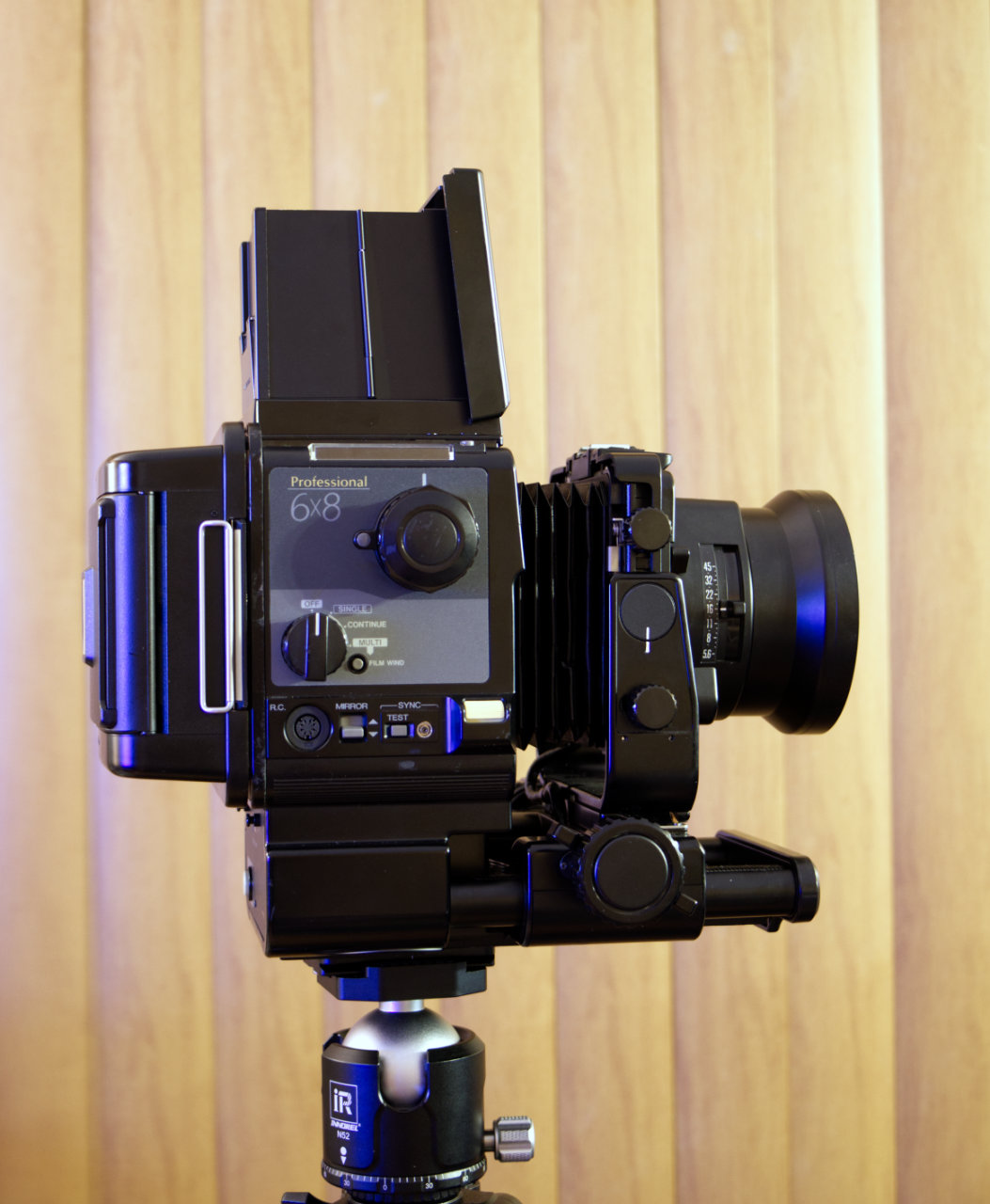

... or, properly subtitled "What the *beep* was I thinking?!?".
Rather than side-track other threads, I thought I'd collect my adventures with this particular monochromatic elephant in a separate thread.
I've been intrigued by the concept of the GX680 since I first saw one-- medium format, but actual, honest-to-goodness large format style movements, and the lenses have a reputation for exceptional clarity and sharpness. The more I read, the more interested I became-- except they use a proprietary no-longer-made battery, and they weigh about the same as a VW Beetle.
After seeing a story by another user who had built their own battery pack, I'm browsing the Bay of Fleas, and I find an example with remarkably good appearance, but it's labeled "untested"-- usually a red flag. The seller (Japan, of course) didn't have a battery, so couldn't test. Well, I saved it in my watch list to think about for later.
Half an hour later, I get an offer for 15% off. At this point, the shipping is nearly as much as the camera, and I've determined there are a couple of low-cost options for a battery pack, and KEH has some inexpensive lenses. A few clicks later, and I was being assured that a camera would be en route to me soon, and a lens classed as "UG" by KEH, along with an actual factory DC power supply (well, it's AC -> DC), would also be here posthaste. Or haste-post.
Two days later, I had the lens and power supply. Power supply puts out 8.13v, lens had some minor scuff marks on the glass that cleaned off with little effort. "UG" my *bleeep*! Calling this thing "BGN" would have been under rating it.
The next day, the camera entered DHL's system, and apparently via wormhole, appeared at my doorstep 48 hours later. That's an average of 150 mph, so perhaps Lewis Hamilton delivered it after being crowned WDC again.
The good: The camera is in remarkably clean condition. The power supply works great. Once powered, all systems seem to work, the only thing left is to run an actual roll of film through. Tried running just backing paper, but instead received a lesson in how long it takes for the film back to spool the backing paper from one spool to another (~ 15 seconds).
The bad: No battery pack-- but I knew that. The bellows have some pinholes, and generally feel... un-supple. Doesn't handle movements gracefully. Can repair, but might be better off replacing. The film back battery is dead, but I expected that, and have a replacement on order. The LED light on the film back is also DOA-- but that may just be because the on-board battery is kerphut.
The weird: Researching the camera, there are 3 models. The Mk I, with the brownish label, the unmarked front standard, the twist knob instead of a lever for focus lock, and the red bar for horizontal vs. vertical. The model II, with the gray label, the "GX680 II" label on the front bar, the lever lock, and the "knives" in the viewfinder that switch between horizontal and vertical. Then there's the model III... and this isn't that one. :smile:
Instead, I have a gray label, unmarked front bar, twist-lock on focus rail, and the switching rails that flip between vertical and horizontal. So it appears to be the main body of a GX680 II, with the front assembly from a GX680 I. Still works though, so no complaints.

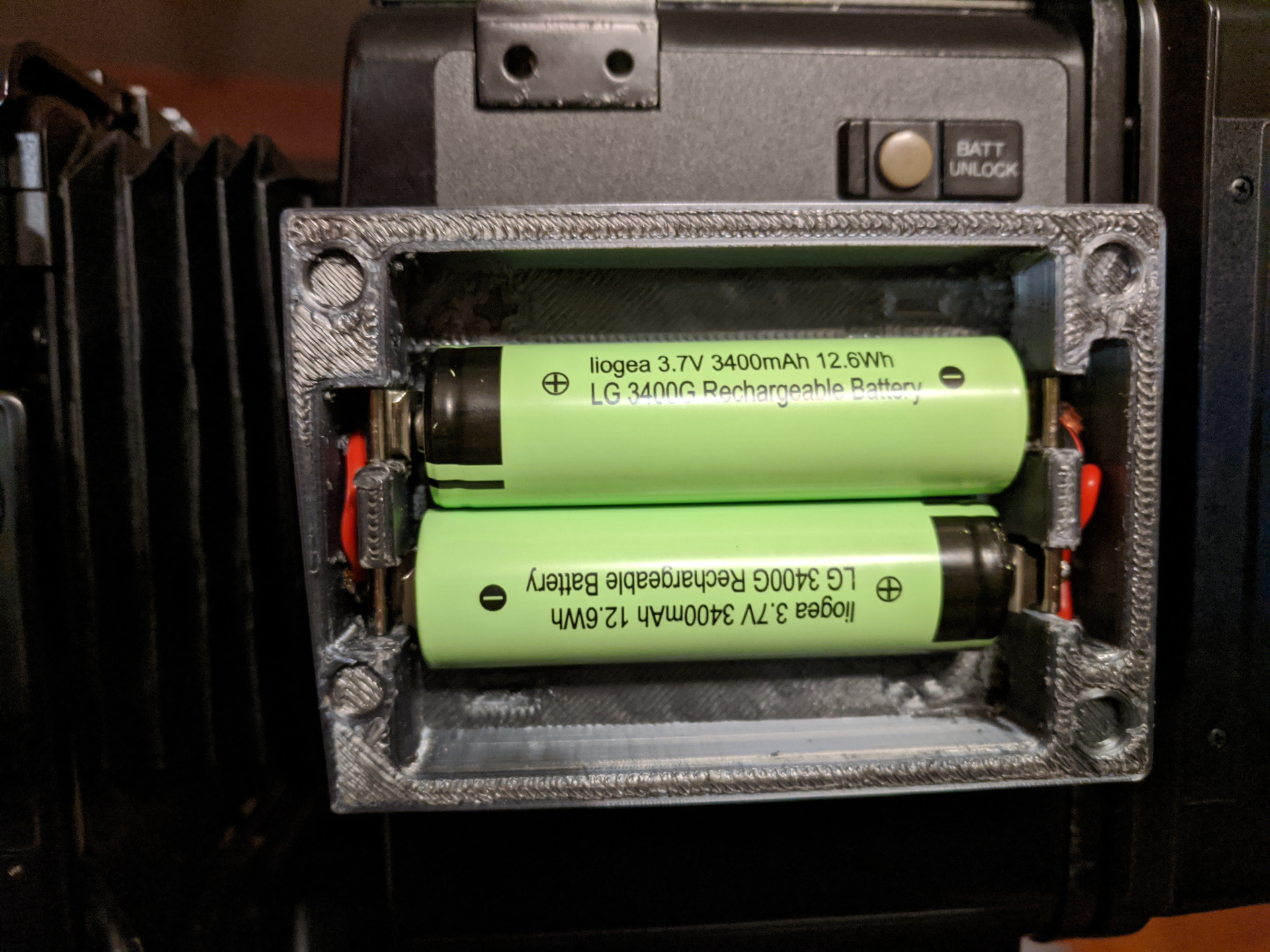

Next up-- build a better battery pack. Thingiverse has a design for an 18650-based battery pack (they're lithium-ion rechargeables that put out around 3.7v-- so two of them should be pretty close to the 7.2v the camera expects from the original NiCd battery pack): https://www.thingiverse.com/thing:3400814
The beast in question:

So after a false start printing the battery pack (4+ year old filament can be temperamental), I've produced a reasonable facsimile of a battery pack that fits very well into the battery holder.
Downside is that there's some support-related issues with the printed product-- I've got this one working, but it's not right, and I want to tweak the design a bit so it doesn't require supports that you can't easily remove.
However-- loaded it up with two 3.7v batteries (which are supposed to be compatible, but not quite, with 18650 batteries), made sure my voltage and polarity was right, plugged it in... and my GX680 is working on battery power. Everything works as well as it did on AC power. :smile:
The batteries are actually slightly shorter than a true 18650, which in this case, is good-- they barely fit in the pack.
There's a lid to print with it, which uses small magnets to hold it in place (the round holes in the corners). Not going to bother with this one, since I intend to reprint it.

Nice work on the battery pack!

@ic-racer: Thanks, but I didn't do that much of the work-- Someone else took the time to design the pack and make the design available. I just printed it, got the right connectors, and wired it up. The nice thing is, since they're rechargeable, I won't be buying dozens of AA batteries to feed the beast. :smile:

Trivial update: Reprinted the battery pack using some tweaked settings, rather than trying to fix the original model. New pack fits substantially better, isn't cracked, and doesn't look like it's been attacked with power tools.
