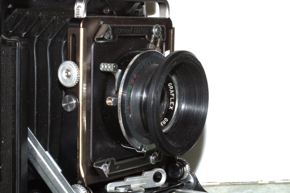

This is a home brew hood with the grazing angle calculated for its Graftar f/4.5 103mm using a sketch and a bit of trig, and machined out of solid acetal bar on the lathe.
It is a press fit on the Graftar and the inside is rough turned.
It is a bit stumpy so it can stay on when the camera is folded.

Nice work Wombat! You ought to do custom ones - sell them on eBay!

It is nice work indeed, I was once an engineer and I know a push fit for this hood to go on the lens tightly enough it needs to be only about 2 thou. larger.
