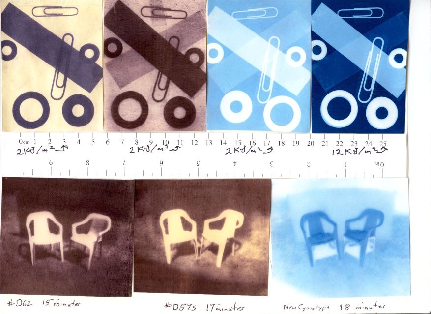

What can be used for smooth surface cyanotypes other than hot pressed watercolor paper, and cheap.
adelorenzo, Yupo won't work w/o a primer, it's absolutely impermeable and with cyanotype you need the emulsion IN the paper.
kevin, try Masa paper it's perfect for all iron / iron-silver processes and it's cheap too. (Something like USD 1.2 - 1.3 per 21x31" sheet... I remember the times when it was only USD 0.7/sheet.)
Loris, am I miss reading what you say here, as with Cyanotype you don't need an emulsion (by that I mean gelatin).
Clive you're right, "sensitizer" would be the absolutely correct term here. But we often intermix these two terms here in the alt-process forum, trivial stuff... BTW you don't absolutely need gelatin for an "emulsion".
Loris, do you coat the smoothest side or the slightly rough side?
