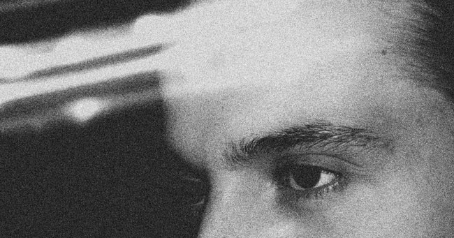

I like HP5+ pushed to 3200 in Rodinal. This shot is from my Leica MP with 50 mm f/1.4 and printed on Agfa MCC paper.
Dennis Rotterheim
