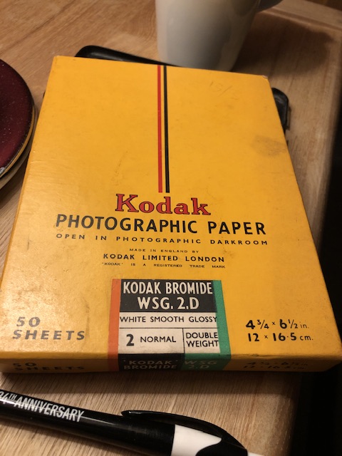

Might I ask...: I bought an old unopened pack of Kodak Bromide paper, I'd guess dating back to the 60's (?) and just started printing with it the other day.
It stinks - really musty! I had hoped running it through some chemistry and then washing it for 45 minutes would remove the smell but no such luck...
I pulled it all out of the pack on a nice sunny and breezy day to try and air it out but still smelly.
Does anyone have any suggestions?

The smell might be largely related to the box and the envelope.

Smell doesn't do anything as far a printing. As Matt said it's the box and envelope.
Doing Lith and using a lot of old papers I get that often with old boxes.

@MattKing I agree actually, the envelope inside was a waxy paper package, and I already swapped that out for a plastic envelope from a finished pack.

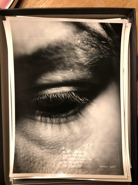

Here’s a rough print, the negative has a scratch and it ain’t the finest image but it was as far as I got with the paper. Whites and blacks and a few bits in between at least.
