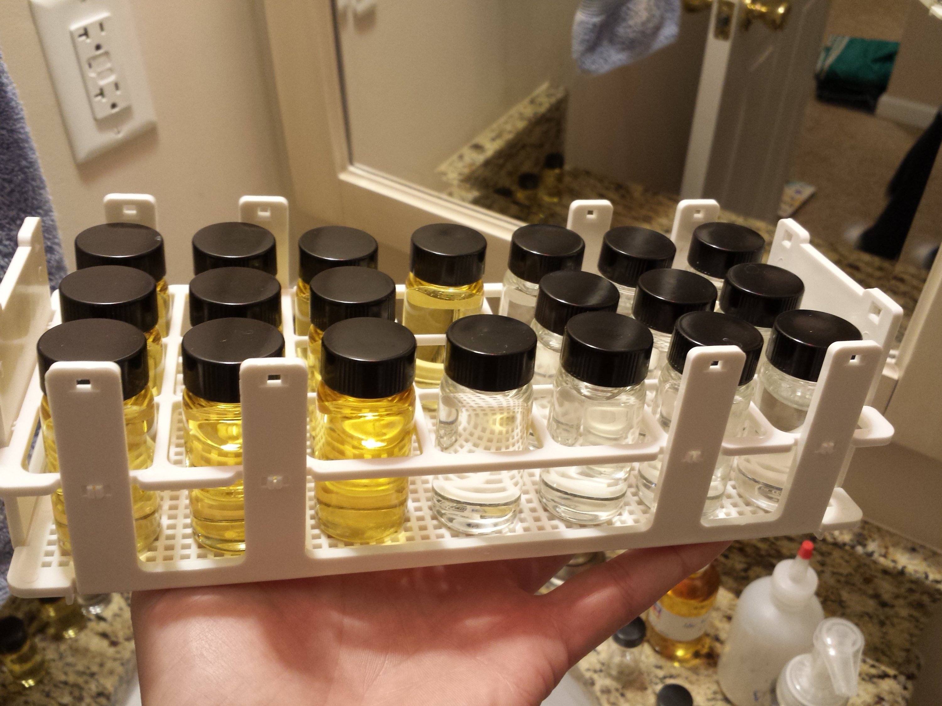

Even better, I got these trays from Amazon to hold my vials of paper developer, fixer, Rodinal, and HC110. Now I never have to measure anything, and the chemicals last forever in the glass vials.
