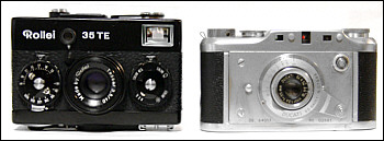

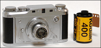

It's not fixed lens, but it is one of the smallest.
It's smaller than a Rollei 35.
The Ducati Sogno.
This is a half-frame rangefinder that uses preloaded film cassettes with a limit of 16 shots, I think. It was made in Italy by the same company that today is known for its high-speed, high-end motorcycles. The price for these regularly goes into four figures - unless you find one that is in rough condition.
