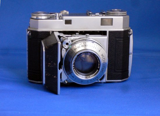

I like the Kodak Retina II or IIa. However neither have a built-in meter. The Retina IIIc is much larger and has a meter. Below is a photo of the Retina IIa..
The IIc has about the same size as the IIa, but is more robust. I have both the Xenon and Heligon version, and prefer the latter.
