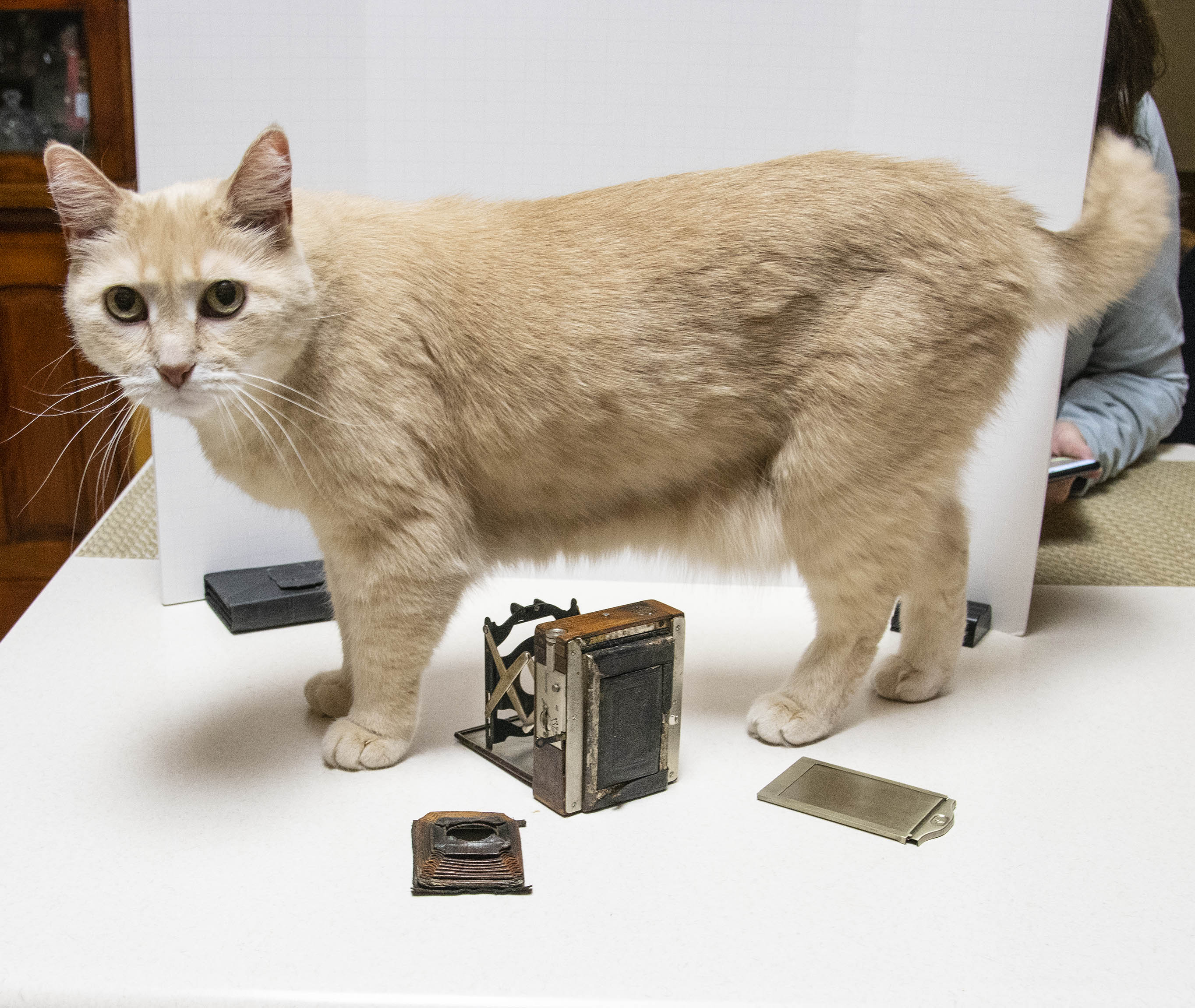

I have an ICA Sonnet camera that takes 645 plates. It's tiny before it's even folded up. Smallest view camera I'm aware of. 1920s/30s.
Kent in SD
gone
Jun 14, 2009
5,504
gone
That's either the biggest cat in S.D. or the smallest folding camera I've ever seen.
Not family photo friendly, though, hence my preference above for roll film (or even 35 mm in Kodak/Leica cassettes). FWIW, that's about the same size as the Ernemann Klapp I referenced early in the thread, but plates aren't something average family photographers would have wanted to deal with. Family photography really started with the 1890s Kodaks (the ones you sent in for processing and reloading after shooting 100 small round negatives). Anything that used a paper-backed roll could be in that category, but as far as I can tell, 127 was the smallest format of that sort of film that had any legs (i.e. lasted even as long as the end of the 1930s).
