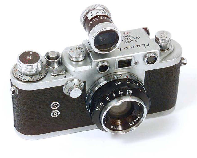

Also consider a Kyoei W. Acall 35/3.5. Very nice compact one and also terrific performance.

Here's the Acall lens I mention above but a rebranded version. Gives you an idea mounted on a LTM camera.
