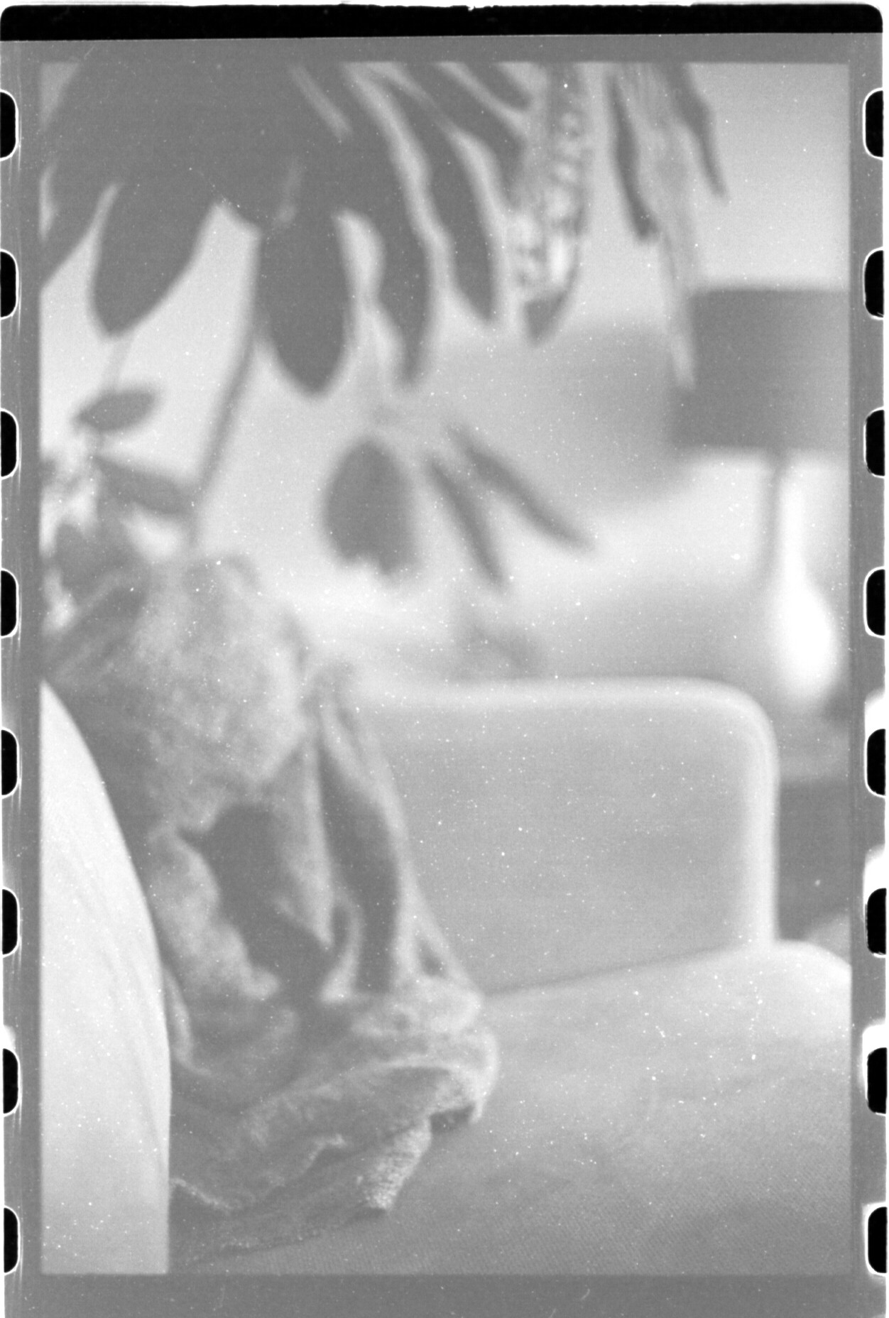

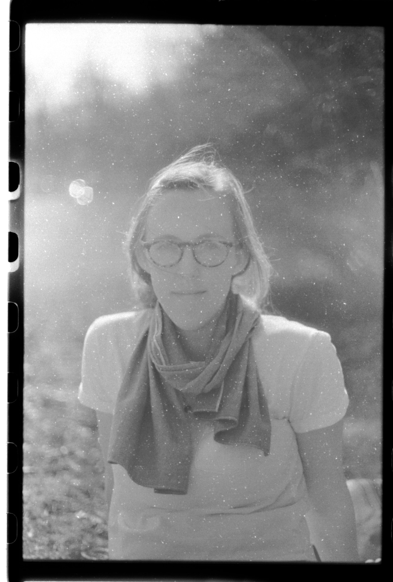

This is arista.edu 400 developed in D76. Did everything the same way I always do it, hung them up to dry in the spot I always hang them. I get dust but nothing this small or this much. It's on every picture, on both rolls I developed together, it's everywhere.
Does this look like anything you've seen before? I've got two ideas right now, maybe a problem with the chemicals (didn't happen last time though with the same batch), I'm also wondering if maybe it's pollen. It's just very very fine and everywhere.

Maybe precipitate since the last time you used the chemicals? If they are white on the contact, it means it is blocking light and that would make sense. Run your soup through a filter, coffee filters and a funnel work for me :smile:

"... don't think it's dust..."
Are you sure? Examine your negatives with a 10x loupe and see what's there. It sure looks like something physically in the way of the light. So, if it's not dust, it may be particulates from one of your solutions that have deposited on the neg. This should be visible under magnification as well. Check your solutions for particulates. Fixer can precipitate silver and/or sulfur when it goes bad.
Particulates from hard water forming on the neg during drying is also a remote possibility. Usually these "drying marks" have contours to them that match the water run-off pattern. Nevertheless, if you have hard water, use distilled water for you final rinse.
If it's not particulates on the negative, but small areas of extra density, then it might be from poorly-mixed developer. Powdered developers often need time to go completely into solution. Using them too soon results in bits of the developer powder sitting on the negative during development and causing extra development in a very small area, which gives a speckled pattern of extra density that looks like dust.

Alan, that's very interesting. And they happen in correspondence with dried water drops? As best I can tell these spots aren't associated with water drops.
I'm wonder if perhaps there's something going wrong in my chemistry. A few weeks ago I took a bottle of D-76 that was already a couple weeks old and mixed in freshly mixed developer. This is my third time using that batch since then (same batch, but of course I dump out the used chemicals) but the first time I've seen these spots. I was hoping the older D-76 would seamlessly mix with the fresh D-76 (and it did for a while) but perhaps the older stuff is now doing something to cause these spots?
As far as particles vs higher density, I'm not sure how to tell. I have an 8x loupe but I'm not sure what I'm looking at.

Just to be clear here. Can you see the particles on the negs with a loupe?. If not, can you see the particles under a grain focuser when the negs are in an enlarger. Are your scans of the negs simply reversed so they appear as prints and are not scans of a darkroom print. I suspect they are not scans of prints as if you had darkroom prints then it would show up more clearly?
If you don't mind me saying so the scans apart from the particles appear to be very low density and "foggy" looking
What I am leading to, depending on your answers above is that if the scanner has produced the grey, foggy look is it possible that the problem lies in scanning?
This may be just me who has missed the obvious as no-one else has even hinted at a scanner issue at all.

Yes, they are scans of the negatives. I can visibly see the specks on the negatives with my eye (but they are very small). As far as the low density and "foggy" look I'm not sure whether that's because of my scanner settings or because of the light leak in the camera (first time I used this fm and there is a light leak, just to be clear the other roll with these specks is from a camera I use often and has never demonstrated anything like this before).

Mixed some fresh D-76 and some fresh fixer, no more spots. I think the D-76 was fairly old and my 1st wash fixer was definitely done. Not sure which one caused the dots, I think it was probably the D-76.
