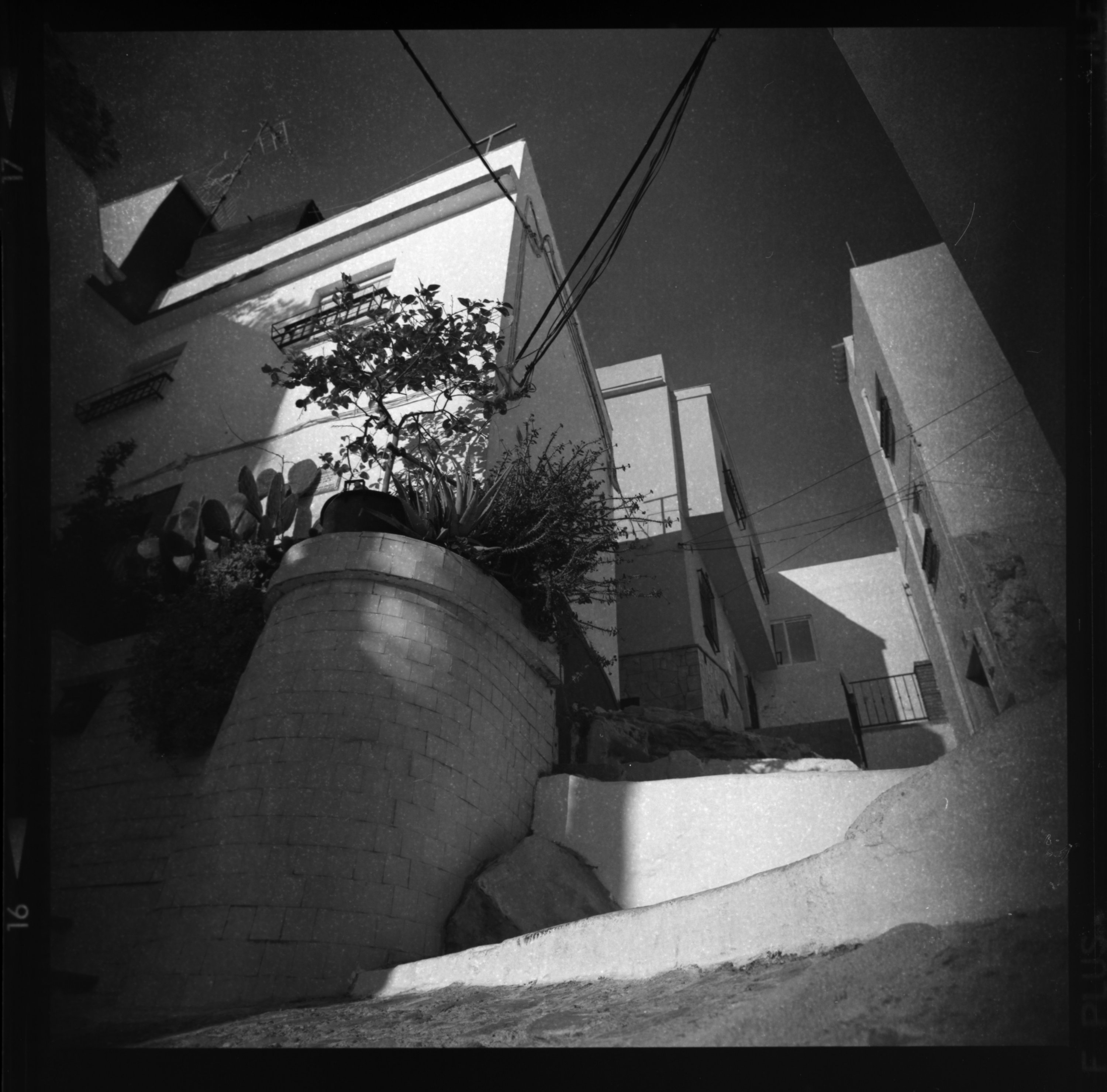

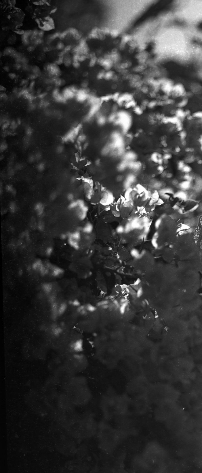

I'm getting thousands of small white little spots, mostly in the shadows. It's specially bad in some rolls I forgot for a year ago before developing (bad latent image) but I can also see it in some fresh exposed ones.
I used a Jobo 1520, manual inversion.
Any ideas?

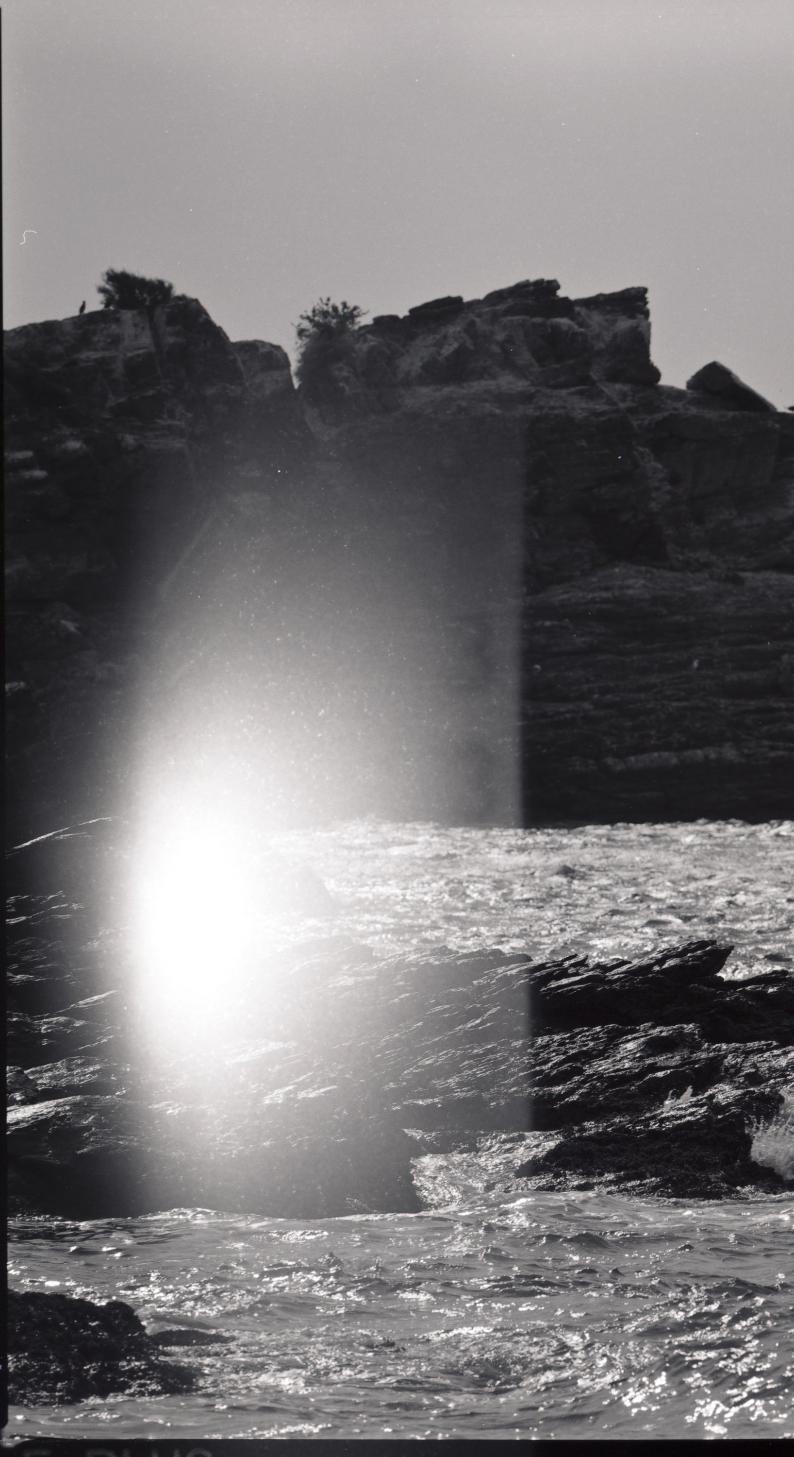

The first time I developed with this was a month ago and I saw these weird spots, but on a light leak, not in the shadows... (all images were fine, except the light leak on the first picture).

It's the film. Pan F has poor keeping characteristics. Latent image degradation is the issue. I love Pan F, but learned you have to process it within a few weeks of exposure for best results.
Michael W
Feb 11, 2005
1,594
Sydney
The Pan F I had the spots problem with was in date and processed soon after exposure. The problem is the film. I'll never use Pan F again.
araucaria
Aug 25, 2014
17
Developed some of this in C41 and the spots persist, so not a powder developer problem. Won't buy Pan F 50 again because after inspecting some other negatives that looked ok and were developed the same day they were taken, they also have the spots in some areas.
