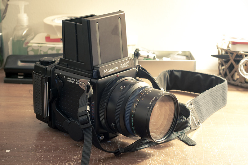

As you guys know, 50mm on the RZ comes out to a focal length of ~24mm on a 35mm film camera. The 110mm is an ~50mm equivalent. The following photo illustrates how wide the 50mm really is:
It’s a bit ugly but hey it’s the function that counts right?
110mm
50mm
