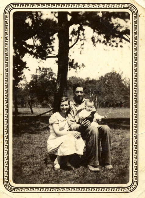

Another thing often found on old prints is a decorative border printed onto the paper like this.
