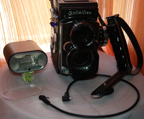

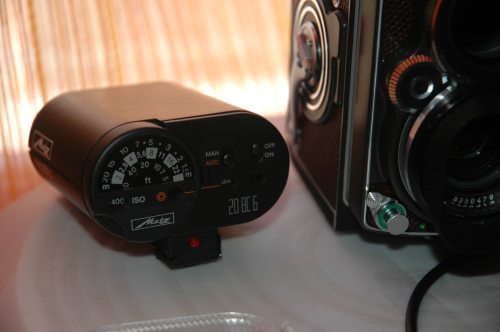

Ok, here is my first report after actually buying a small flashgun.
I went to a local photography store and happened upon the Metz Mecablitz 20B5. It seems to be an older model, now discontinued but very possibly still available in stock. I bought for 28 euros, which is not a bad price, but I am sure I could find it cheaper if I looked. But I didn't have to look, I tried it on the camera on the store and didn't have to pay shipping or wait.
I haven't fired a shot yet, but I am looking to go through at least a roll of HP5+ as a test. Its use will still remain fill flash for street and travel photography and thus I wanted something small and not powerful. Just enough to light up a face a stop or so and give some catchlight.
It fits on a L bracket and connects via a PC cord.
If the show of the bracket is metallic like mine, you need to tape the hot shoe plug of the unit. As you can see, it fits slightly above the lens where normally you would want a flashgun a bit higher. I could get a taller or expanding L bracket but unless the light is really ugly, that would be too much. Also, the bracket I have, falls back a bit and tilts the flashgun at 45 degrees and I am meaning to tape a white plastic sheet and try it with a slight bounce. I might even be able to get a 90 degree tilting head,
but that might be too much for such a weak unit. Its small though, fits the bag, goes very well with the Rolleiflex and its convenient to hold and operate the focus knob.

I think the placement of the flash near the lens will give you an interesting journalistic look. I don't know of any street photographers actually using fill flash on a regular basis, so that will be somewhat unique. Diane Arbus did some close flash stuff that I like.
arigram
arigram
Sep 21, 2004
5,465
Crete, Greec
Yeah, Arbus used the Rolleiflash with its bare bulb and reflector, probably at full strength to give that look. I am going for a softer effect and I am thinking that on photographs like this one
I want to retain the dark look but maybe give a stop more to the subject and also get the catchlight to bring out the eyes. But I like that photograph, dark as it is as it gives the feeling of the place, with the fish sellers usually in the dark and with all the light falling on their displays.
The Metz 20B5 is small enough to fit in the bag along with the bracket so its not a problem to carry, as a more normal flashgun would be. Its a tight fit with all the accessories really.
I found Hama selling two interesting shoes: a hotshoe to PC and a 180 degree tilting shoe. The latter, more useful will enable me to try the Metz unit tilted 90 degrees upwards with a bounce.
