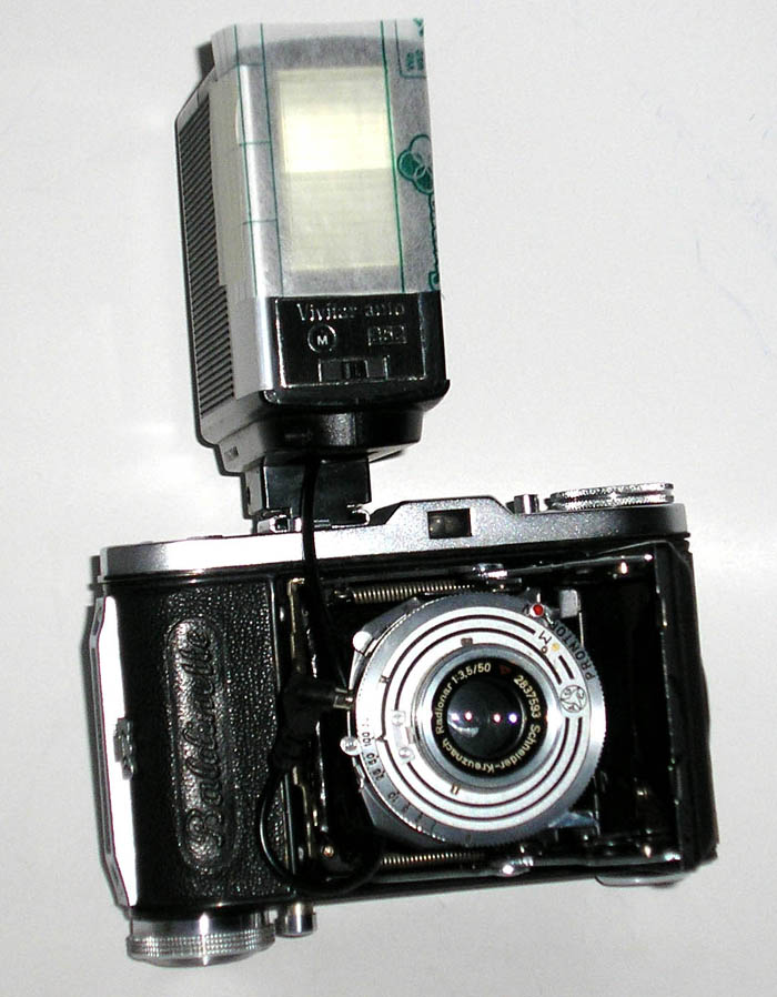

The flashes I was referring to fit any camera with a hot shot; there is no automation with the camera (although some have a thryister circuit that provides automation within the flash). I suppose the most common brand is Vivitar, though similar flashes were also made or branded by many other companies. For example: http://www.bhphotovideo.com/bnh/con...023&is=REG&addedTroughType=categoryNavigation
My favorite (of the ones I have) is the Vivitar 252 which has a built in PC cord (shown on my ressurected Balda Baldinette). The camera-end of the PC cord plugs into a socket on the flash, which enables the hot shoe; unplugged and the hot shoe is now cold. On the flash is just a scrap of glassine - it softens the light a bit and I lose 1/2 stop.
I just pick these up used when I run across them. Usually $3-5. Just check the battery compartment to make sure there is no corrosion.
