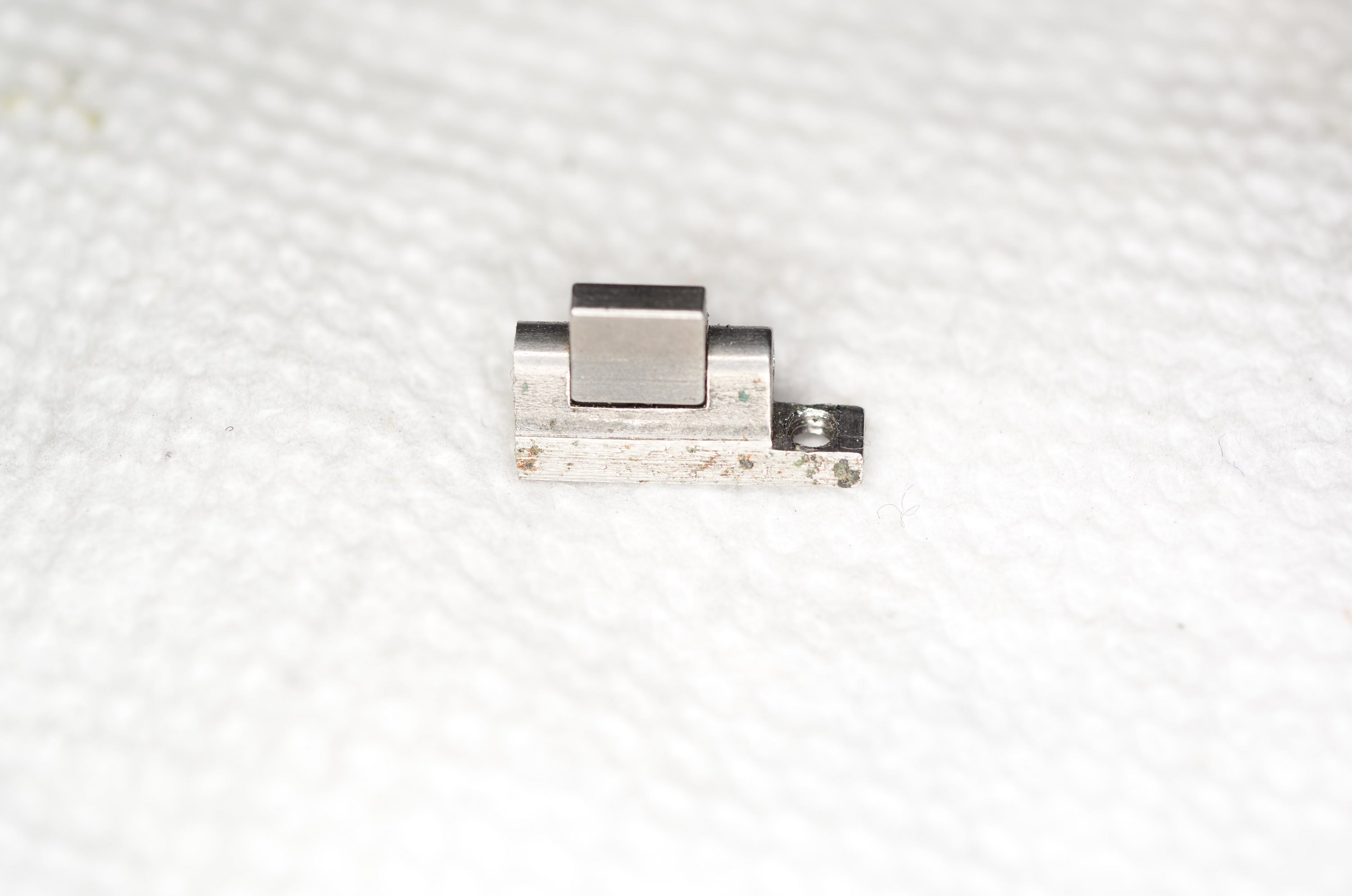

Don't forget that you can fold infinity stops down, slide the standard past them, fold the stops up, slide the standard up to them.
I have a infinity stop with the rear screw cut off at the fold pin.
