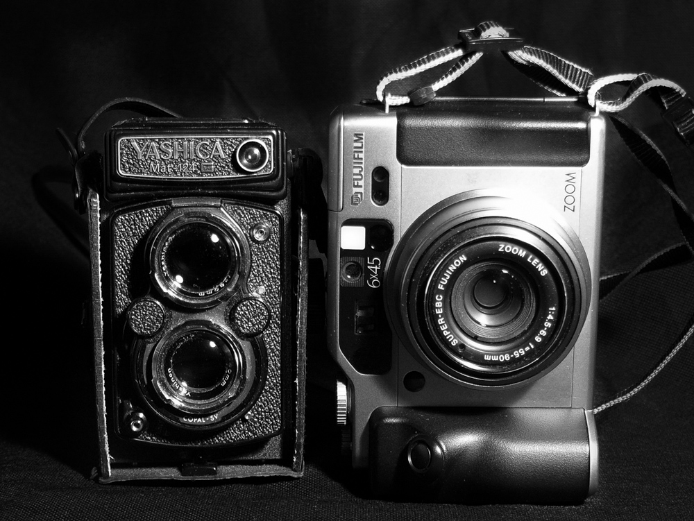

I figured a Fuji 645 would be the winner, but then I saw this picture and forgot how big the Fuji is compared to the 124G.
