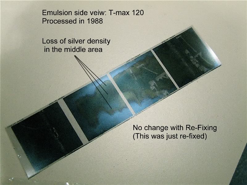

I had a similar issue with some film from 1988. I do much better processing these days. I don't re-use fixer anymore.
View attachment 205503 View attachment 205504 View attachment 205505
Thank you for these images! This is what the negs look like, but based around high density areas rather than toward the edge. My greatest hope is that the problem lies in my young processing, and that my slightly more experienced self, who made better images next year, also fixed and washed better and my slightly better images survive with much better success. I will check negs from 2000 onward next week. Stay tuned...
Jarin
While mostly dealing with historical glass negatives, according to this dissertation silver mirroring is the result of the emulsions contact with external sources of sulphur (H2S etc) and not a result of poor fixing (which will create different problems). Storage (humidity, ventilation, contact with storage materials) apparently plays a big part and It would be interesting to know how the affected negatives were stored.
"It has been observed that mirroring often does not occur on poorly processed prints. The sulfur from the residual fixer combines with the silver ions to form stable silver sulfide before the silver can travel all the way to the surface."
source: "A Guide to Fiber-Base Gelatin Silver Print Condition and Deterioration" by Gwain Weaver.

What you refer to is not dichroic fog but silver mirroring, a layer of silver sulfide that forms at the surface of the emulsion. This kind of damage is caused by image silver in the emulsion that is oxidized in the presence of other chemical compounds like hydrogen peroxide, then slowly migrates towards the surface of the emulsion where it reacts with environmental sulphur (mostly hydrogen sulfide H2S) to form silver sulfide (Ag2S).
This gives a good summary:
https://archivesandspecialcollectio...of-photographic-degradation-silver-mirroring/
