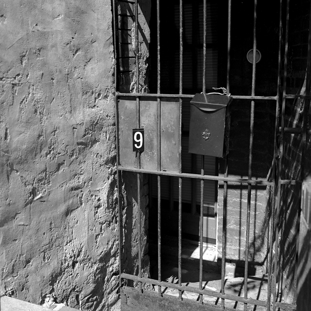

I just posted some examples in another thread of PanF shot at EI 12, developed in Pyrocat HD, developed semi-stand 1:1:200, 45 minutes at 75F (the reason for the high temp? that's the coolest I can get out of my tap in the summer). You can't get finer grain or smoother tonality than that...
here's another...
