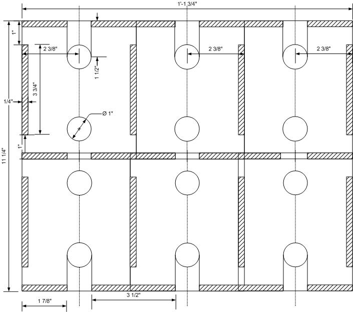

Here's a dimensioned drawing (inches - I'm a dinosaur) for a slosher that holds 6 sheets and fits in an 11x14" tray
Looks fairly easy to make. If I were doing this, I would add some sort of handle to each end so it can be moved around without getting your fingers in the developer..... Or am I missing something?
