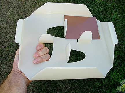

Is this what you all call a "Slosher"?

Have you used that particular model? Based on that design, and imagining what the flow of developer would be like around the 'fins', I would expect that surge marks could be a problem.....
Looking that the photo you shown, I would worry about that also. All I known is the PF one works great. Haven't has an uneven developed or scratched neg since I started using (now if I would quit doing other stupid mistakes).

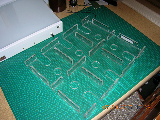

Here's a photo of my home-built 4x5 slosher. It was modeled after one that Chip Forelli let us use in a workshop last summer that in turn was modeled after one that he had used in a workshop with John Sexton.
The dimensions are not critical - the inside dimensions of each of the six "boxes" has to be slightly larger than a sheet of 4x5 film - I made mine about 4.25 by 5.25. The overall outside dimension has to fit into your 11x14 tray. The holes are 1" diameter. Each box has two 1" holes - the idea is that lowering the slosher into the tray forces chemicals through the holes - this lifts the negative sheets a bit, both for agitation and to assure that chemical flow all around the sheets. I cut an opening from the "outside" hole in each "box" to the edge of the bottom to provide a way to grasp each sheet of film.
Total construction time was about an hour - I bought one sheet of 1/4" plexiglass at Home Depot from which I was able to construct both the six sheet slosher and a smaller unit that does two sheets in an 8x10 tray.
